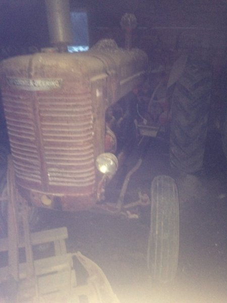

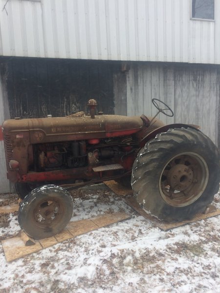

    Brought her home today snapped a pic before we tarped it cause it was starting to snow pretty good. Got to do some shuffling to get her in the shop IMG_2284.JPG

    That's a nice straight tractor and decent rubber too. Going to be nice when you get done.

    Straight is right! And all original the only dent I see is on the top of the one fender almost looks like someone whipped an apple at it otherwise even the slats in the front grill are perfect and on an old IH that's never the case

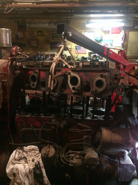

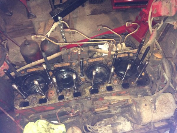

    So far I've found....
    -starting carb cracked in pieces
    -a few coffee cans worth of walnuts down the exhaust manifold into the head
    - diesel in the oil of the injector pump
    - throttle lever cracked
    -#3 and #4 starting valves stuck
    - hole in radiator (not sure if it leaks or not)
    - intake stack pipe half cut through from the hood
    -broken seat spring
    All in all not to bad I don't think.
    I've got a new carb already and all the gaskets coming to get the head back together. Hopefully with some cleaning I can get the starting valves unstuck and working.

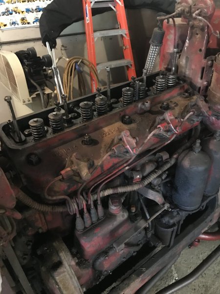

    It's been quite a while since I've touched a wrench to it but today, with a little encouragement from yesterday's tractor show I did some work on her mainly to get the head off my bench. Back in the early spring I hunted down a new carb, gasket set and a few other odds and ends. I ended up stripping the valve train, cleaning the head as well as fixing the two stuck starting valves. This tractor has a pretty unique starting system it incorporates both gas and diesel. Starts on gas and switches to diesel after it's warmed up.

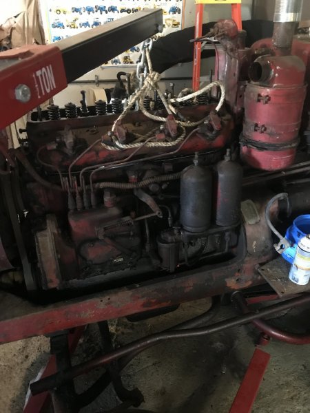

    Cleaned up the top of the block, bottom of the head, new head gasket and set her down. IMG_1610.JPG
    All torqued 125 ft/lb. and hooked up the injector lines. IMG_1611.JPG Took the tappet covers off to make sure I got any of the crud out of the tappets before I dropped in the push rods and ran out of time for today.
