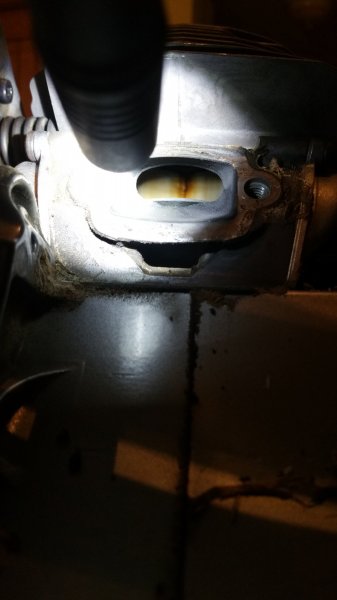

    Not sure how it happened or if it actually did. Have not used my saw in a little bit and for some reason I am not sure if I transfered some fuel to my chainsaw can and got side tracked and didnt add oil or what. So I topped off my saw to go and do some cutting today. Cut for about an hour and the saw cut out on me maybe like 4-6 times. Didnt think anything of it really, figured it might be some restricted air on the filter being dirty or what not. Finished cutting and went to add the splash or two left from the can and saw it didnt look mixed.
    Needless to say I am freaking out. Not sure what to do. Can I add the correct mix and cross my fingers and hope it wasnt straight gassed? Do i need to rip it down and look to see if the cylinder is scored? If so not really sure on how to do that. How much do the parts to fix it cost if I did mess it up? My heart is racing over here and I am kicking myself for making such a stupid stupid stupid mistake.:mad::headbang:o_O:headbang::headbang::headbang::headbang:

    Take off the muffler real quick and have a look before you do anything

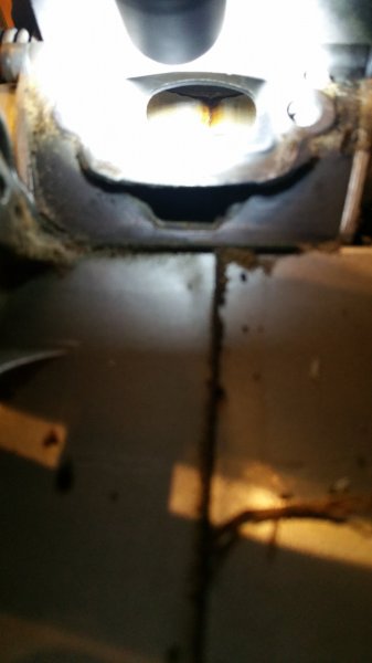

    Ok took it off and this is what I see. This brown mark goes down but not all the way. This is looking straight into the cylinder I dont see any scored lines on the sides.
    another

    :dex:Ouch. Can you put some straight oil and roll over without plug, clean it and fire it up and see how it runs? Disclaimer, I am not a mechanic

    Usually within a minute or two with no oil running wide open they lock up tight Seeing how it ran for an hour I don't think that you straight gassed it. Maybe a little lean on oil but from the looks of the piston nothing to worry about.

    Doesn't look scored. But to be safe I'd empty the gas and put fresh gas at 40 to 1 in there and try it out.

    Roll the piston up see what it looks like.

    Ran it for an hour? Can you post a pic of the spark plug too? Severe lean condition should show on the plug as well.

    That saw wasn't run for an hour straight gased. Period. God Bless

    As redfin said rotate the piston up & check it for scoring.
