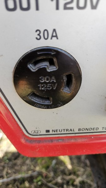

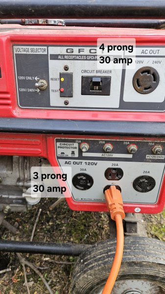

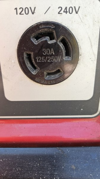

    Hi. I have a 30 year old Honda EB5000 generator. 5000 watts which probably provides 4700 usable watts? Pain to start but once it does it runs forever. I never really needed more than a 20 amp circuit to run fridge and maybe a few lights when we get power outages, which is too often-Old neighborhood, lots of trees, no investment in infrastructure. Anyway, I'd just plug a cord into one of the two 20 amp outlets. But now, I need more power to run a couple of additional small appliances. So, I got a 4-prong generator adapter(turns one plug into 3 120v circuits to run appliances)and plugged it into the 120/240 30 amp outlet. For this, I switched the voltage selector on the generator to 120v/240v. Is this better, no different or not as good as getting a 3 prong adapter and plugging the 3 prong into the 3 prong 120v 30 amp outlet on the generator? See pics.

    That machine is rated for 4500W continuous, 7000 surge. What additional appliances are you wanting to add? A fridge and a few lights is a fairly light load.
    I assume everything you want to run is 120v?
    Personally, I would just plug into the 120V/30A outlet with an adapter/splitter...if that's not enough, then you can direct plug into a 20A with a regular cord. But you already bought that cord, so
    as for your question, as I understand it, switching to 120/240 gains you nothing, unless you actually need the 240V.
    You might want to buy a Kill-a-watt meter so you can see what the actual starting/running amps are on things...they aren't very expensive...$10-30, depending on brand/model and where you buy it.
