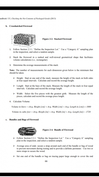

  9. Ohio
    May 26, 2018
    1,919
    18,385
    Not Ohio
    Here is the official way to do it.
