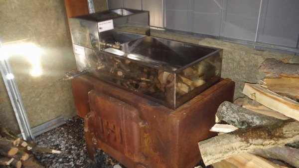

    This is my set up nothing elaborate boils around 5 to 6 gals an hour and I usually put out 10 taps made almost 2 gals of syrup last year. 0222141554.jpg
