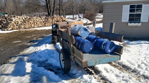

    Put out 60 taps today.
    One of the latest times I've ever tapped.

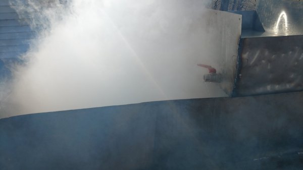

    Made a finishing pan out of some scrap stainless and two door kick panels(304). It was Sunday and nothing was open!
    Used .030 MIG wire as filler and tiged it together.
    It cut my finishing time into 1/6 of the time and will double as a pre heater over my main pan!
    Went from 8 gallons to 4 finished gallons in an hour!

    Boiled last night using my "preheater"...
    Went from 22.5gph to 27!!!!:banana:
    I think if I run good dry hardwood I can hit 30 an hour!
