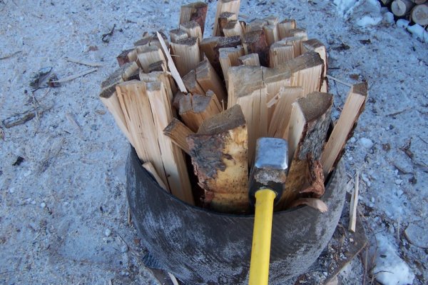

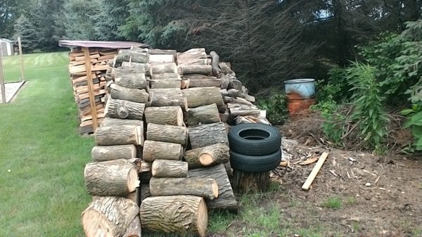

    tmp_7176-P_20150618_143254-1847109784.jpg yep! I like to double stack my tires so no splits fly out.

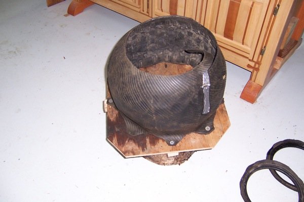

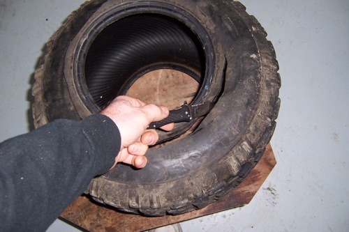

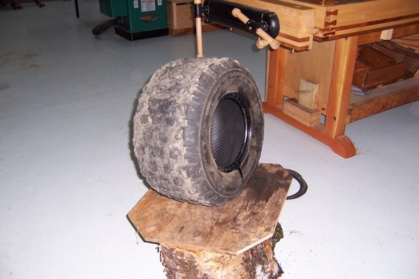

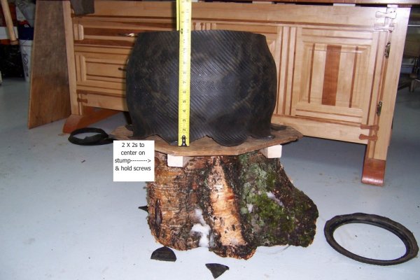

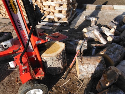

  7. bogydave
    Good idea

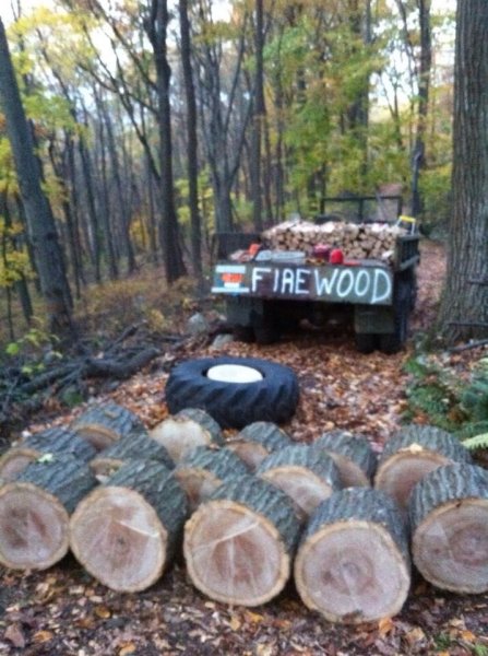

    I used an ATV tire, a little taller
    Cut the sidewall out & turned it inside out
    Star the bottom to use for screws on the plywood, screw the plywood to the stump
    Works good for kindling too:
    has been replace for a few years now : Still split vertical though :D :::
    Horkn, concretegrazer, HDRock and 6 others like this.

    Tractor tire here. I love best the 20-23" rounds that barely fit.

    I use a X27 and never had problems with the tire. Those tires can take a lot of abuse. You won't get into the steel belt. A lot of flex in those tires. I double my tires up so the splits stay in and there is a little more flex if you do hit the top tire.
    Horkn and MightyWhitey like this.
