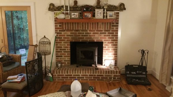

    Hey guys trying to get a good answer on this. I slammed a NC30 into a fireplace and am wondering if i need a mantle shield. From the stovetop to the underside of the mantle is 26". Sorry for those who saw this in my other post just trying to finish this install up tomorrow and start a fire!
    There is nothing in the manual discussing this as they dont really intend for these to be in fireplaces.

    I think I'd prolly move that bird cage too, ifn there was a bird in it;)

    Can't tell from the pic if the stove is already installed in the fireplace.

    that's straight out of the NFPA211 table 12.6.1
    when there is not an applicable listed clearance as in this case refer to the 211.
    so yes our OP has 26 inches, which is too close so a shield would be required
  14. mike holton
    mike holton
    Oct 31, 2013
    472
    1,402
    Old Dominion
    the 211 states 24 Ga. w/ 1inch spacers

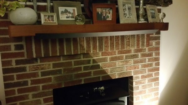

    Thanks for the input mike she is up to code on mantel clearance now
