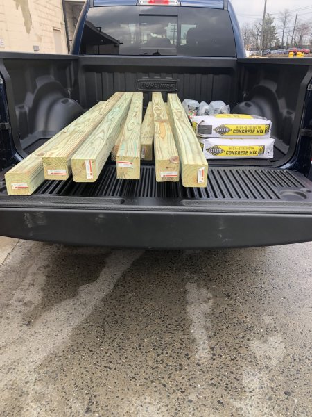

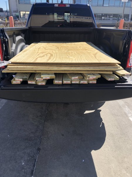

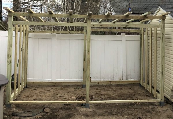

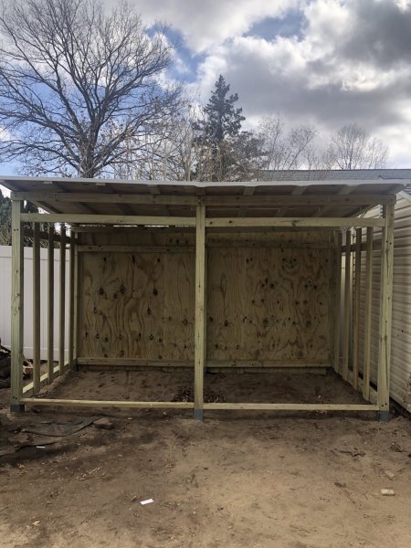

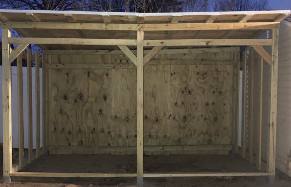

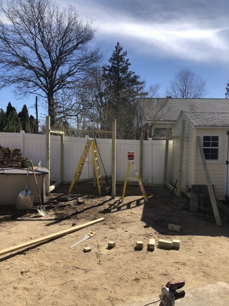

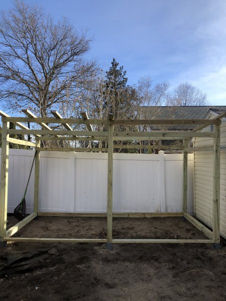

    Been planning on building a shed to organize all my wood and get on a 2 year plus plan here on LI. Space is limited to store wood so I planned on a 6’ by 6’ by 12’ shed. It’ll hold 4 cords stacked when full.
    Me and my dad (74 years old and going strong thank God) said Ef this corona crap. Lets build it now.
    Just about done after 3 days. Tomorrow corrugated steel roof goes on and then she’s done. Will put pavers down and stack on them.
    $600 in lumber. All pressure treated. Framed with 4 by 4s all
    around including 6 cemented 20” down into the ground.

    I have a touch under 3 cords ready to be put in. Leaving myself a walk in I need another half cord. I know where to get just that much

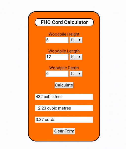

    A good time to get it done! Nice job. It should hold about 3 1/3 cord full.

    A cord is 128 cubic feet
    The inside of the shed is 504 cubic feet
    So packed to the gills (which I won’t do) is a hair under 4 cords. I’m looking to get 3.5 cords into it

    I see where Dennis said what he said forcapacity. It's out bigger than 6x6x12 inside?

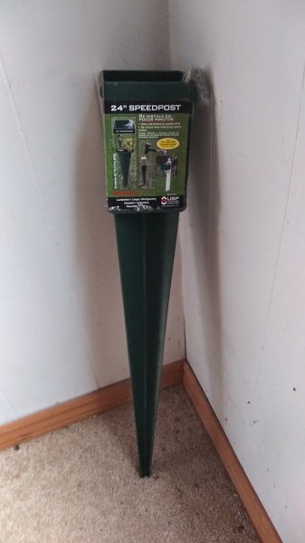

    What are those metal deals holding the bottom of 4x4s? Haven't seen those before.

    The ones I have are called "Speedpost"
    Pound these into the ground. Keeps the posts out of standing water issues.

    6’ by 12’ by 7 1/2’ tapering to 7’

    Correct. Dig a hole. Put em in. Concrete after

    Ok, that makes sense:yes:
