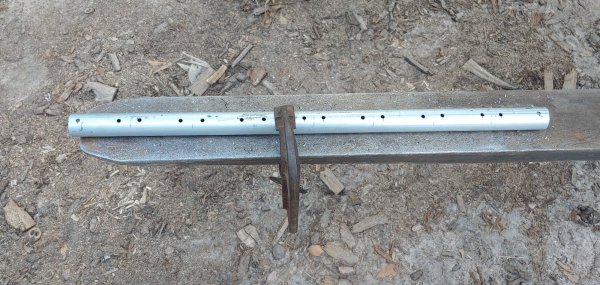

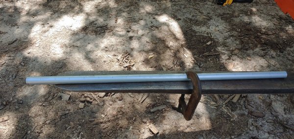

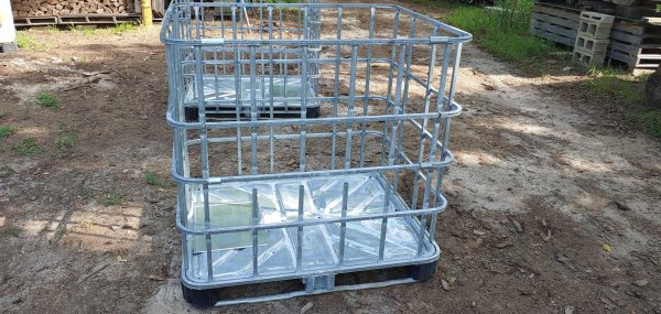

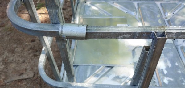

    We recently found a new supplier for totes. Got 4 last week. Looked like the other tote we have with the square tubing cage. Prepped 2 yesterday morning, then discovered the tubing was slightly thicker and the 3/4 conduit fittings we normally use for hinges and latches wouldn't fit. Time to put the redneck thanking cap on...
    We picked up a stick of 1" EMC conduit and some longer metal screws.

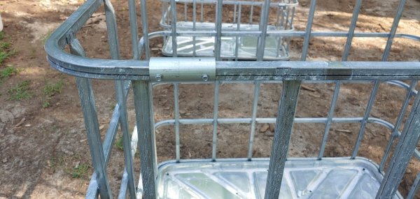

    Got the pieces laid out, enough for 4 totes...made hinges 2" long, latches 3" long... 0821231601.jpg
    Then made the latches, used 2 screws, keeps tote from spreading... 0821231708.jpg

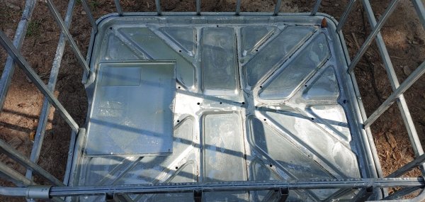

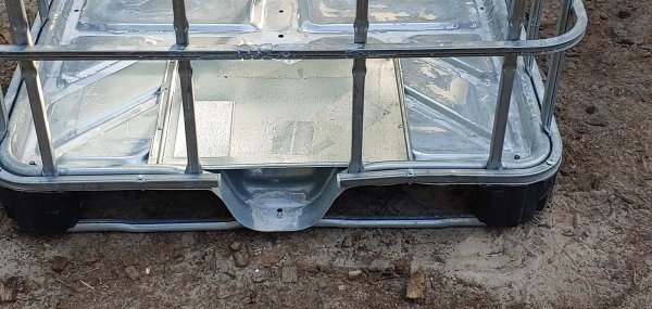

    Also used the ID panel, cut in half a
    Depending on length and orientation of splits, that really helps. Short splits want to fall out.

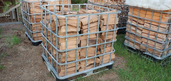

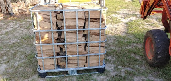

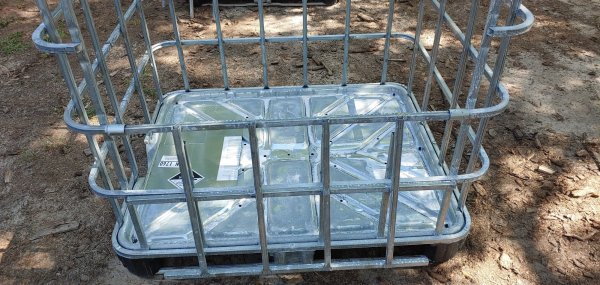

    We used both totes to stack the short post oak smoker wood. 0821231901.jpg 0821231944.jpg

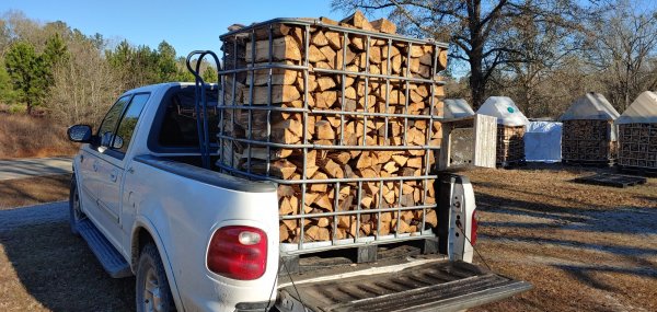

    They do work great. Makes delivery easy too.

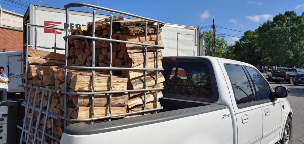

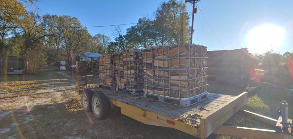

    1/3 cord going to a restaurant 1228220938_HDR.jpg
    Carried 2/3 cord to 1 family, 1/3 cord to another stop. 1117221623_HDR.jpg

    Looking good Jeff. They are a great time saver; just wish I had a tractor here to move mine around. Question, when you load in the pickup, do you slide it to the front of the bed or strap it down? Had a friend who had to make a sudden stop and the tote slid forward pushing the tote into the cab. No major damage, but something to think about.

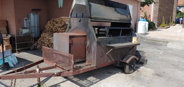

    We take our hand trucks, unload the tote and wheel the wood behind the 2 smokers... 1228220938a_HDR.jpg 0602231029.jpg

    Thanks for the advice. I don't slide it to the front, don't think the tractor will reach it. Probably need to start strapping it. Thinking about trying a small trailer. With the door oriented on the wide side, I have very little room to slide it between the latch stubs.
