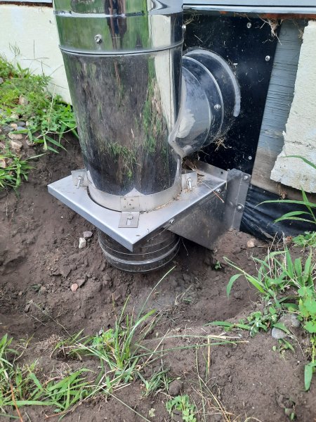

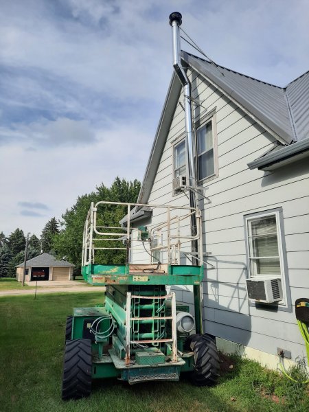

    I asked an acquaintance of mine if I could borrow a scissor lift so I can sweep out my chimney. This will be about the 5th year that I have had a wood stove and haven't done it ever. So, I figured it was time.
    It was actually remarkably clean with very little soot coming out when I was sweeping.
    I think I'm burning right.

    Nope, thats a pile of dirt. Had to dig out the bottom of the chimney so we could get to the cap. I said it was clean......:cool:

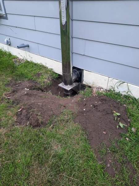

    Oh, and yes, the cap at the bottom is about 6 inches below ground level. I had it dug out, but over the last few years it had filled itself back in just a bit. Had to dig it out again to get the cap off.
    I want to dig it out more and buy one of those basement window wells that can prevent dirt from filling it back in.

    That is quite a hole!
    Im not sure those window well thingies are very big.
    Maybe half a larger drainiage pipe.
    Or retaining wall stones or bricks?

    thats exactly how mine is. Except instead of pre made window well it’s blocks glued. Been this way since 97 at least as the house was lifted for new basement then.
