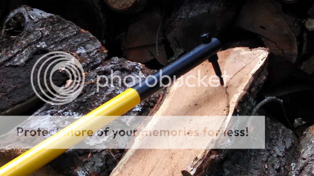

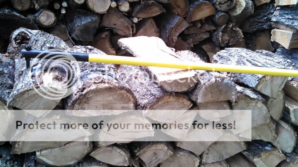

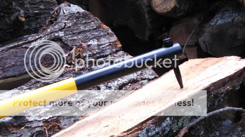

    Saw it as being something handy to have around the wood pile. Price of a new one was a little more than I was willing to spend on the hap chance I would like, or use it.

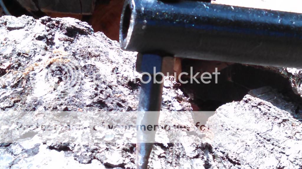

    So I had a piece of old antenna pole laying around. Cut it to 4' long. Inserted about a 6" piece of heavy wall aluminum in the end for a little weight. Used a 7/16" bole that was 5" long that I ground to a point for the pick. Painted it, and called it done.
    Works good. Going to use it as is for while, but may cut it down to 3" overall length.

    Nice! I love when people make their own tools. :thumbs:

    Jeez, you may want to consider making a few more and selling them. Just looking at it from here, it looks professionally made. Very nice

    Nice job GrJfer, it looks like it will stand the test of time.

    HD you are the one that gave me the inspiration to make my own. I saw a picture of it posted somewhere before and decided to do it.

    Nice work on that GrJfer! That will come in handy many times over.

    Even painted.
    Yellow & Black , Mccullough colors .
    Very nice.
    Handy tool !
