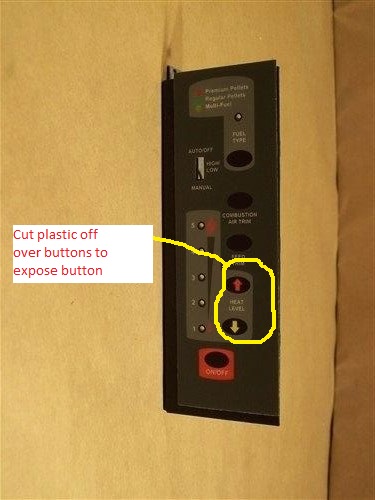

    Greetings
    I will post again just in case someone might have come this since the last time I posted the problem.
    My stove will not allow me to adjust the temp., meaning moving the "HEAT LEVEL" up or down.
    It is stuck on one.
    I have replaced the daughter bd already and I think it my be time to replace the mother bd.
    It is a expensive item so I just want to make sure I am not missing any thing before I purchase a new one.
    Further- Any suggestions as to where to purchase a new Mother Bd?

    I am sure you have addressed this, but I was having trouble adjusting the heat level on mine and it turned out that the push buttons would not work. I had to cut out the plastic over the button to expose the switches.

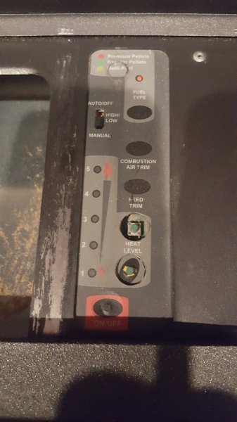

    A little dirty, have not done the fall clean up yet.
