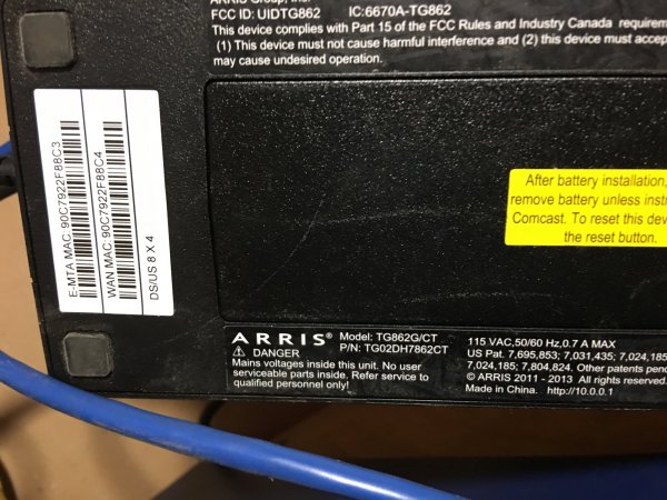

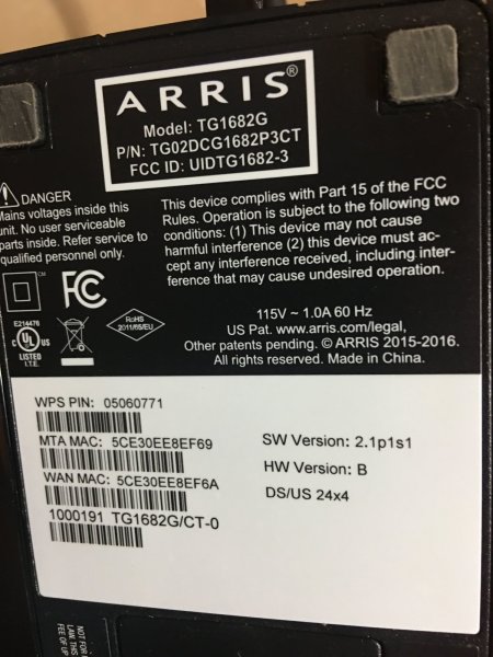

    It turns out that the Comcast Arris router model TG862G/CT (see pic 1) had a bad memory and could not remember the WiFi name of the Iris cameras! Therefor soon after the Iris Cameras were disconnected from the Ethernet wire they conked out and the camera setup showed the camer WiFi name was gone! This did not happen with my Cisco Router and I knew the fault must be in the Comcast Arris WiFi router! So I soon learned that there is a new Dual Band Comcast Arris router model TG1682G after escalating my issue from Comcast Phillipeans in Asia to Jamaica in the Caribbean! See Pic 2 new Comcast router.

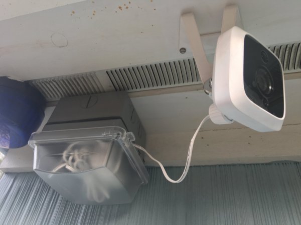

    All I had to do now was to take my new Iris indoor/outdoor wireless Camera and install it at the best vantage point under the eves on the left front side of my split entry house. Well wireless is a bit of a misnomer since after you setup the new camera with the Micro USB connected into your wired network or what they always tell you is to plug it directly into your Comcast Modem/router that you still need to plug the camera into an AC outlet!

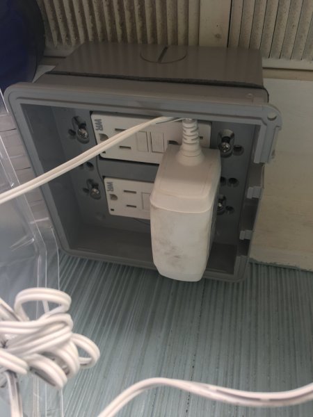

    So my helper and I spent all day today (9 am to 6 PM) installing an outside wether proof outdoor outlet with the big bubble cover. However the camera transformer is so large that you must use a duplex outlet box with duplex outlet cover!
    So what should I do with the second outlet? Ah ha! I ran a second 14/2 wire to that outlet to a hallway switch to make it a switched outlet for Xmas lights! Also to satisfy the codes these are GFCI tamper proof and WR (Weather Resistant)

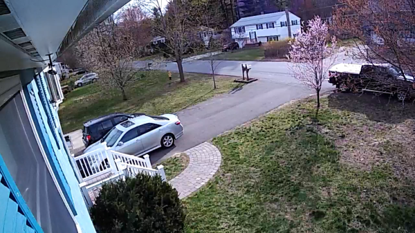

    Now all I had to do is bolt in the new Iris IPhone Canera and flip the 180 view rotation setting switch, adjust the angle and plug in the transformer to my new Duplex Outside Outlet!
    See pics 3-5

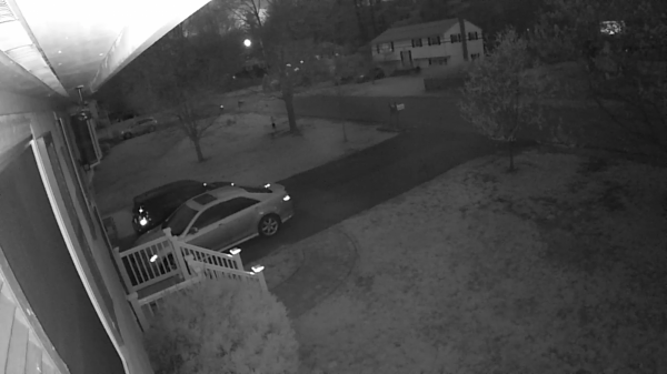

    P.S. Night vision ( See last pic) not bad. :)
    Also with enough ambient lighting goes back to color at night!
    Pic 1 - old Comcast modem with bad memory
    Pic 2 - New Dual Band Comcast Modem
    Pic 3 - New Duplex GFCI Tamper & WR outside outlet under eves mounted to soffit
    Pic 4 - Latest Iris Indoor/outdoor camera
    Pic 5 - Finally the end result - The view as seen on the iPhone!!!
    Pic 6 - Night vision with infrared feature not bad. :)
    Pic 7 - shows with car headlights there is enough light to go back to color! Very Nice!
