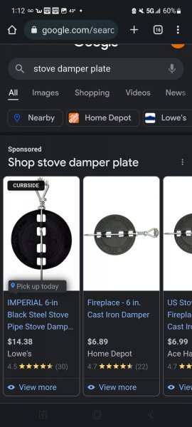

    With such a large fireplace do I need to seal off the damper so I don’t loss a lot of heat up the chimney??

    Yes, if you are putting the stove in the fireplace you will want to put a block off plate up to seal between the fireplace ceiling/damper and the liner attached to the stove...but many stove shops will balk at doing it, they say its "sealed" at the top...yeah, kinda...but there is still a lot of heat to be lost up into that unheated masonry cavity.
    You might consider putting storm windows too...properly installed storms can make a huge difference!

    If my stove shop doesn’t do that. Do they sell them on line or does it have to be custom made

    They sell them online really easy to find.
