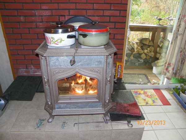

    Lots of factors come in to play on this. For sure you need something that both you and your wife like the looks of. After all, it will be sitting in your room like a piece of furniture so why not get something that looks really nice? Our Fireview looks just as beautiful in the summer as it does in the winter. btw, the Fireview should be about ideal size.
    One thing for sure is that the newer stoves do require much drier wood than the old stoves but there are many benefits which come because of it. For example, we cut our wood needs in half when we installed the Fireview. Another thing is chimney. We used to clean 4-6 times per year. At present we are into our 8th year with this stove and have cleaned the chimeny twice and neither time did it really need it. A super clean burning stove.
    Here is our stove. No apologies for the pans on top as my wife was making applesauce at the time. Yes, we do cook on the stove.
    Make sure you get a stove that is large enough, as you stated. If going too small, you won't have enough heat for overnight burns. Our stove is 2.2 cu ft.

    Dennis, could you please post a picture of your stove exhaust from the above picture???
  10. Backwoods Savage
    46,213
    290,176
    18" to the wall. 1/2" rise per foot of horizontal. Outside is the tee and then straight up with class A.

    I didn't realize you vented horizontally on your stove.

    It is how we had the previous stove so we just went with that. Quick and easy.
