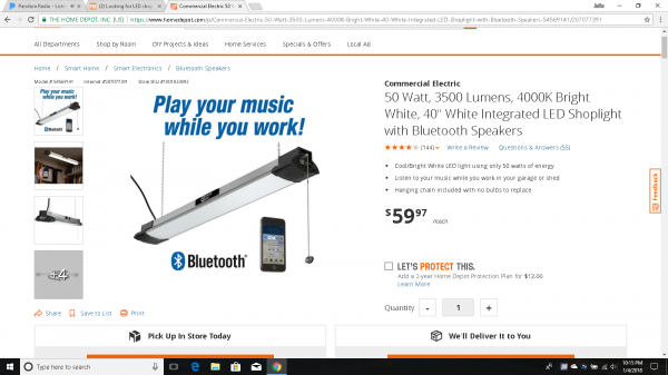

    I have the 4 ft ones from big orange replacing the dual T-12's. More light, no flickering when cold in the basement. One over the bench has a built in Bluetooth speakers which I really like. Not high quality sound, but works fine for me. The two remaining fluorescent fixtures will be replaced.
    Old fixtures were hard wired, so the new ones have plugs. I added boxes above and now have a a place to plug in a tool if necessary.
    I think they were 40 bucks-ish. A little more for the sound one.

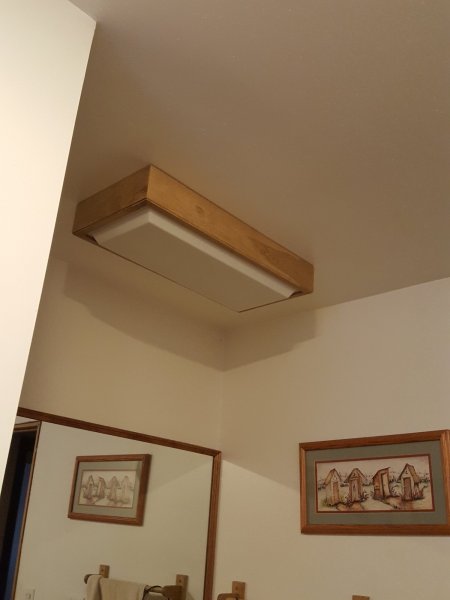

    I just retrofitted a nice older 2' wood framed fluorescent fixture over the vanity/mirror.
    Something needed replaced, either the bulbs or ballast. Bulbs really didn't look bad, but were starting to flicker.
    Very nice. Easy. Cut the ballast out and rewire the tombstones on one end.
    About $50 for two 2' retrofit bulbs and 15 minutes time. :yes:

    I like the idea of this over the bench
