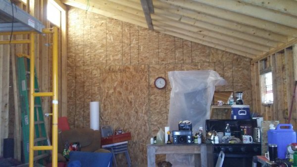

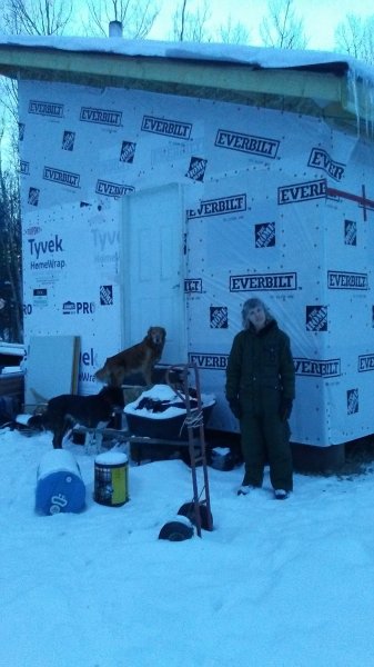

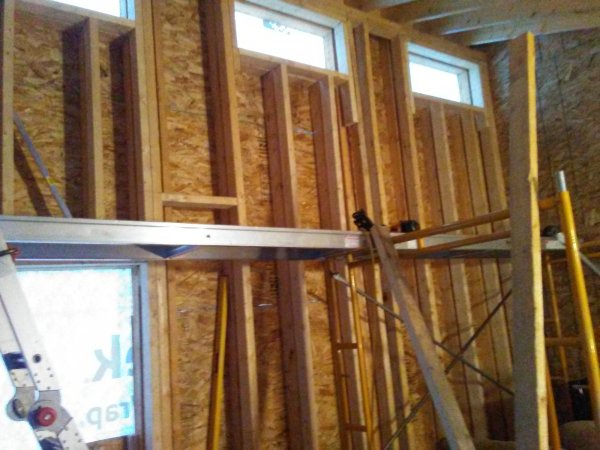

Wow, cool. Rope; yes we moved to Delta. We LOVE it here. The house is gaining on it. Had a bit of a bobble this year. Blew my left rotator cuff completely. Had reattachment surgery on April 29 and got out of the pillow sling on June 10. Geneva is standing on what I started with then. (What I got done before the snow stopped me LAST year). And where we are at the moment. Got the roof on before the snow came. I had no idea you had a fire. I hope everyone is OK ?
