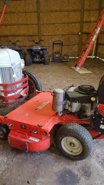

    Looking to buy a ztr, any advice is appreciated. I mow about 3 acres of our nine acres. Land is rough, old farm land, so durability is a high priority. Thanks for any and all advice!
    My current mower:
    Would like to keep the cost under 6K.

    @benndatomu and ironpony , thanks for the responses. I like the Ferris, I will take a look. Thought about a lghtly used homeowner model, but my mechanic skillz are average at best!
