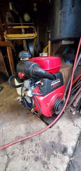

    Hello everyone, sorry I haven't been on much. You know me, I'm always busy! I've been rebuilding a mini skid steer specifically for our tree stuff for the past two months, thats on top of real work and my tree escapades. I'm looking at building an auger powered splitter, so of anyone has/finds/sees at Stickler or other big cone for sale reasonably priced, please LMK. Also looking for a standard-flow auger drive.
    The mini skid I got is an old OMC Mustang 312, I've already repowered it with a Honda GX620 v-twin, totally rewired the machine and am still in the process of adding an auxiliary hydraulic circuit for the grapple bucket and auger attachment. Installing counterweight pockets in the rear for the heavier big rounds as well. Should be a good little machine for my purposes.
    If yinz know of any cones/auger drives, please let me know.
    Isn't she cute?
    Old Kohler 18hp flat twin being replace with the Honda GX620 V-twin
    Heres the Honda all set up with the stub shaft and dual pulleys for the drive motors. Also made a new harness, fabricated throttle and choke adapters as well as a bell crank to use the Mustangs original throttle controller
    Fitment was tight but worked out.

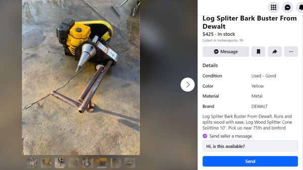

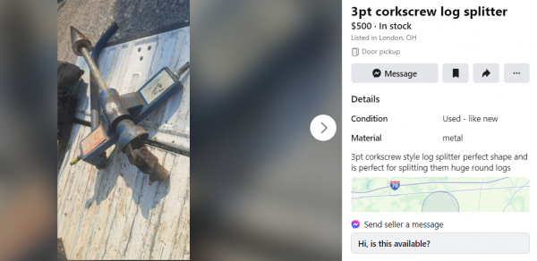

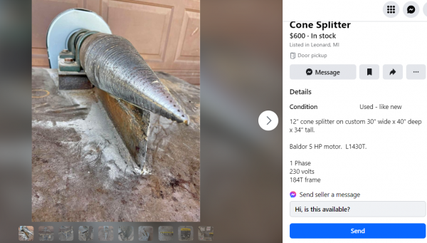

  9. brenndatomu
    23,727
    152,888
    Can anybody see this link, cuz I can't...
    Here's a screen shot...
    metalcuttr, Chaz, eatonpcat and 3 others like this.

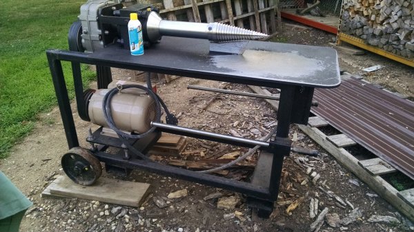

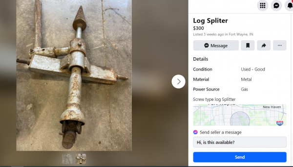

  10. T.Jeff Veal
    27,350
    172,152
    Probably not big enough for your needs, but my dad made a screw type splitter years ago. We still have the splitter, with the screw tip end, I think.

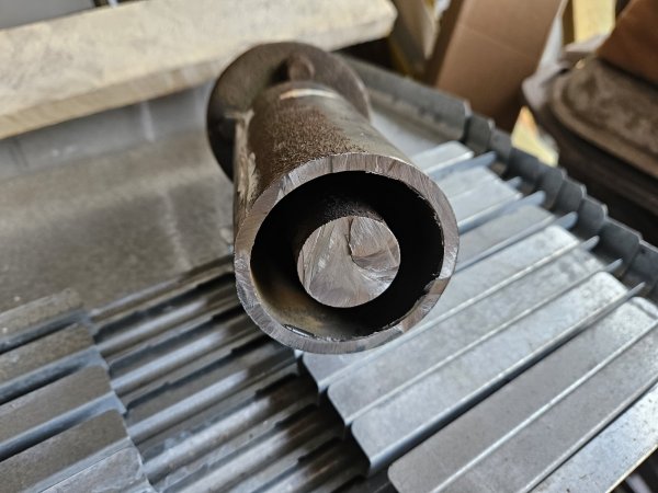

  11. Screwloose
    Screwloose
    Jan 15, 2017
    5,400
    31,564
    Wondering if the shaft telescopes through the bearings?
    This was meant to be a reply to Dave's picture, sorry.
    metalcuttr, Chaz, brenndatomu and 2 others like this.
  12. brenndatomu
    23,727
    152,888
    No idea...my guess would be no.

  13. Screwloose
    Screwloose
    Jan 15, 2017
    5,400
    31,564
  14. brenndatomu
    23,727
    152,888
    Telescoping PTO shaft I'd guess...

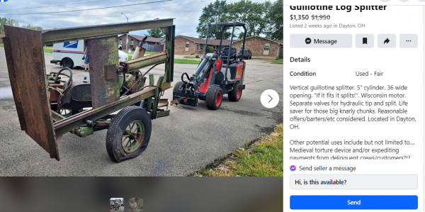

  19. brenndatomu
    23,727
    152,888
    Just seen this, in case you are still looking Scotty Overkill ...Kent is about 45 minutes from me...probably close to Ohio dave

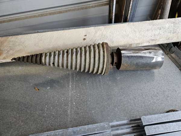

  20. T.Jeff Veal
    27,350
    172,152
    I sent the Barkbuster tip, cone and piece of shaft from the unit we had to Scotty Overkill 20231121_100637.jpg 20231121_100624.jpg
