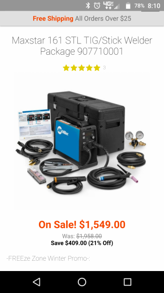

    Get yourself one offer these super handy little welders, Tig capable, and stick capable, I've got one and it was a great investment, 110 plug on or 220. So it's super portable, I've been doing my part time business about 2 years now and have only had a dozen calls where I needed the portable and this has suited me fine. And most of those were only $100-$150 jobs. I will say as the maxstar does an awesome, actually phenomenal job in the portable, mild and stainless Tig realm, the stick welding (at least with 110) could be better. Be ready to flip a couple breakers if you've got a bunch of stick to do with 110. So before spending more than a couple Grand on a true portable generator welder, test the waters first. Only downfall on this machine is no aluminum Tig. But I have a Miller diversion 165 for that, which is also fairly portable, but isn't great for a ton of welding but it's done everything I've needed it to so far. I haven't had a lot of need for aluminum either but certainly helps pull a couple customer's in that end up coming back for mild or stainless work, so that's a plus to have right there. My wire feed is an esab migmaster, either a 175 or 275, can't remember off the top of my head. It can lay some great beads with the 90/10 gas and I feel comfortable welding anything with it. Push pull gun for aluminum is available but unless your doing a TON of aluminum it's not worth it, last I priced that it was $700, a starter Tig in the MWS that I was in ran $750. That's a no brainier if you ask me. It would be nice to have a little wire feed for the lighter projects and to do some portable faster and better than stick welding though. Next on the docket that I absolutely recommend, spend the extra money if you haven't already on an evolution saw, 14" blade. Forget about those stupid abrasive cut off saws. Don't even think about buying one. Watch a couple videos on YouTube and you'll quickly see why.
