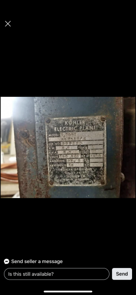

    Looking at an older Kohler 6.5kw generator, the data plate says 50 cycles, which I’m guessing means 50hz.
    Can this be changed via idling up the rpms a little to make 60? Or is this set in stone. I already have a 5500 Screamin demon generator. The one I’m looking at runs at 1800rpm and liquid cooled, elec start, which is appealing.

    Here’s a data Plate pic

    interesting that it says 1800 rpm for 50hz. Frequency X 120 ÷ number of poles is synchronous rpm. Check the frequency and voltage as you speed it up and see if it regulates and keeps the voltage at 120/240.
