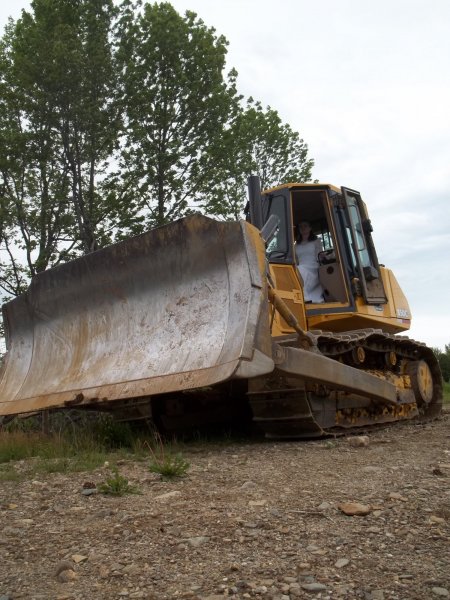

    You and me both! I know what you mean though. Thankfully, due to retirement I have a lot of time now, something I never used to have, and as such it is just me alone in the great Maine woods just doing my thing with chainsaw and bulldozer. My wife...we work well together, but she is forever thinking of ways for her as a stay-at-home wife to make money when I am like, "just drive the bulldozer so I can get more wood cut in a day". She won't have none of it though. She will drive the Kubota but not the bulldozer...scares her she says.

  8. papadave
    82,468
    Maybe she's just afraid of tearing that pretty dress?
    She doesn't look very scared sittin' in there.
