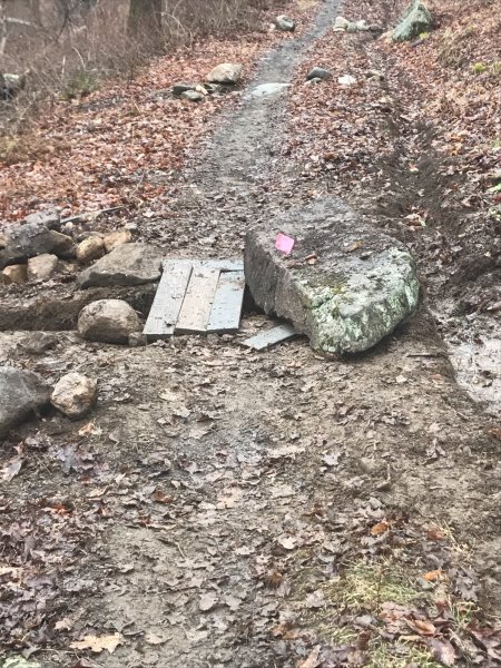

    First I'd say to get out when its raining hard or just after and identify where the water is flowing onto the road. Then make some diggings to ditch/crown/divert and drain that water. The sooner it is off the road the better. Sometimes by going above the you can divert water before it gets on the road or channel it all to one spot where you can show it the way across. If your road traverses a hillside, angle the outslope so water can run off and get rid of or poke drains in any birm on the downhill side to let the water run off.
    Then augument/patch the chronically wet spots, which are presumably now the low spots.
    And finally maintain your ditches so the water does not back up.
    This is a hiking/biking trail on a 100-200+ yr old logging and mining road. It was chronically muddy. A ditch on the high side and drains every so often across it have firmed it up. The granite slab happens to be readily available just above it so it gets used as a bridge at the ditch in our case. That slab still needs to get placed. We've also used pipes which would be better if you need a wider road.
