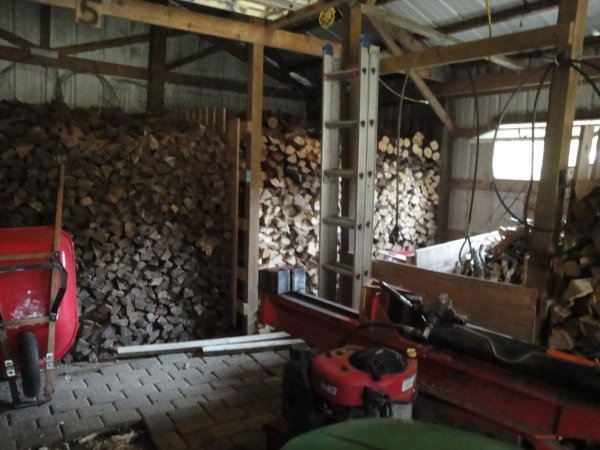

    DSC03620.JPG DSC03623.JPG Pole barn fills up quickly with the garden tractor trailer and log splitter in there. Only time splitter is left out side is when I am doing multiple days of splitting and the weather is nice.

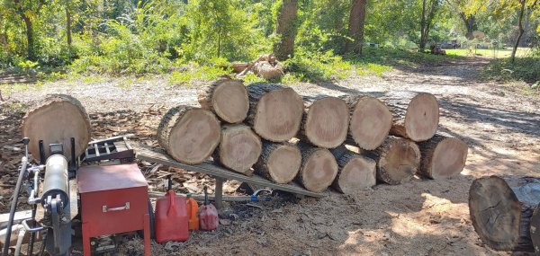

    When we used the TSC 30 ton all the time, we had a metal box built to cover the engine. I need to get a tarp to coverbthe whole splitter now. 0927211233_HDR.jpg
