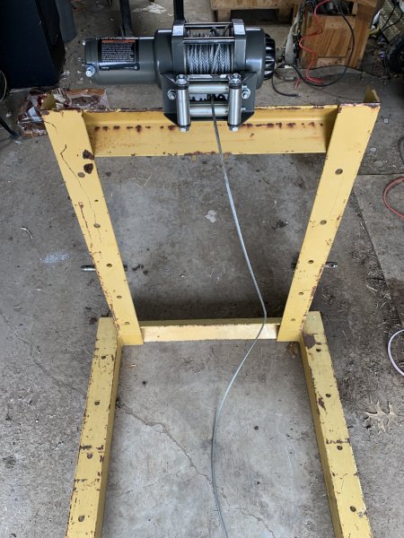

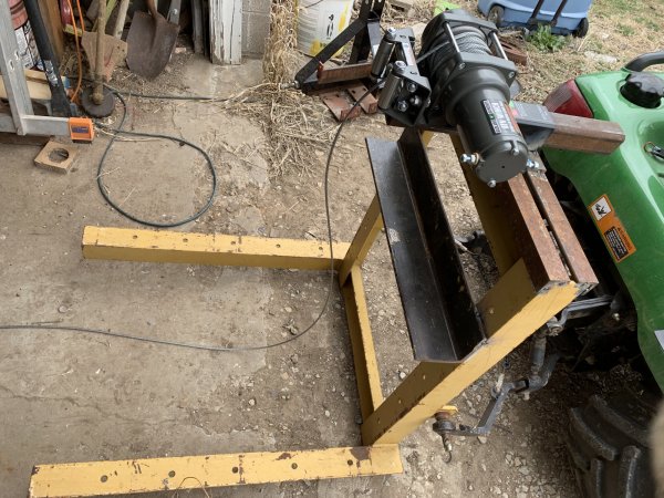

    Got the winch portion... tacked up.... Think I’ll get another square tube reducer for the chain holder.... It fits my square tubes nicely.

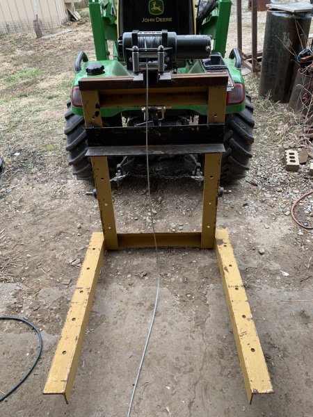

    Took it out for a test run...:tractor: ...it accomplished what I set out to start with. :thumbs: Now I just need to hook up the choke chain setup... drill my hole for the winch tube...possibly figure out a way to install something to go in the dirt to block off the JD...and figure out a way to get a battery installed and possibly a way to keep it charged....:sherlock:

    Looks like a sweet setup. One thing to consider is trying to build an angled base plate or some teeth face back towards the pull, to avoid pulling your tractor. It looks like a 3500 lb unit, so a stubborn log or snag could yank the unit backwards. It might also reduce a little stress on the back end of that sweet green machine also!! Enjoy :dex:

    Thanks...:handshake: ... Yea I noticed that yesterday... the carry all already has an angle back on the very bottom.. I shoved it in the ground and threw the front bucket into the ground... really stabilized the JD....:thumbs:
