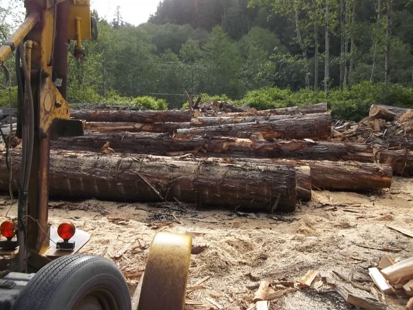

    This stack of logs looks pretty good from the side but they are low grade and are of no commercial value but they are good for firewood.

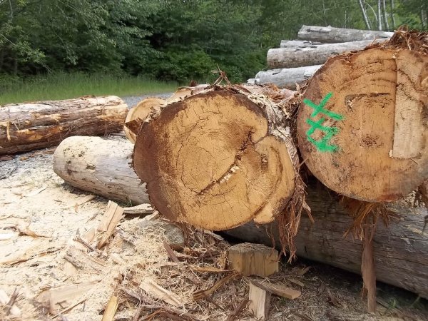

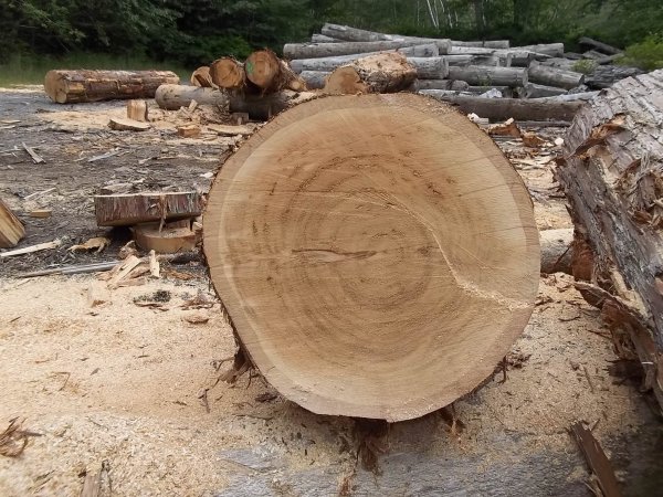

    The ends of these logs show a different picture. This one is wind shook and will just fall apart if it is turned into lumber.

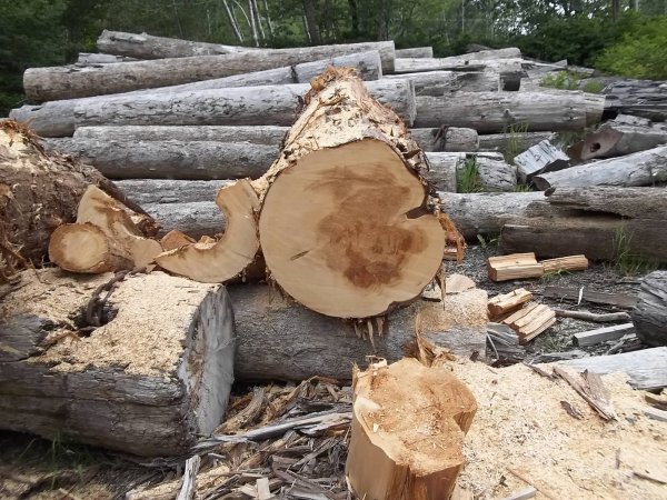

    This one has heart rot. Not enough percentage of the log is good enough to make it commercially viable to transport it to a mill over 250 miles away.

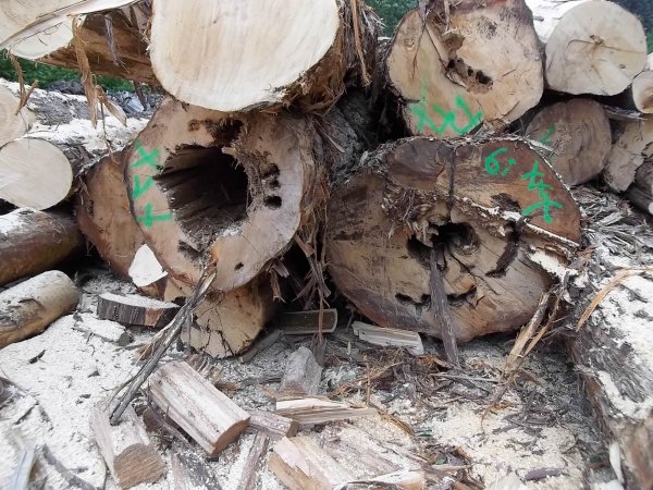

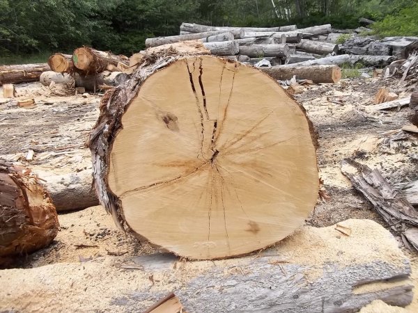

    These two have pin rot and shatter.
    Three of these have heart rot and the white faced one has pocket rot.

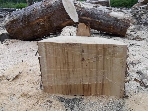

    Side view of a round that has pocket rot. Great for firewood but no good for lumber!
    This is an end view of the round that I cut in half.
    Most of these logs are only 10 to 16 feet in length and are from logs that have been upgraded with ends cut off before being sent to a sawmill.

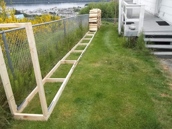

    Got out for two loads today!
    Yesterday
    Today!
