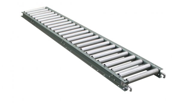

    Use a dolly and ramps for my trailer but it’s not tall like a dump trailer. It’s an equipment type trailer with a dovetail so pretty low.
    A steel conveyor with rollers might work good for your situation.

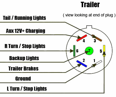

    Trucks with a 7 pin rv style plug should have wiring in place that can charge trailer batteries through a hot wire in the plug. You may just need to add a fuse in the fuse block under the hood.

    You have to be careful with that. The dump (or a winch) can try to pull a load through that wire blowing the fuse protecting it if the dump battery is low. Then no charging.
    The best way is to install a relay that disconnects the truck charging wire when the load is energized.
    Or redneck way (which I do now) is to disconnect the trailer cable when operating the dump.

    My last 4 trucks have used the hot wire to charge dump trailers, tilt trailers and the camper. No problems so far but none of those use much power.
    Thanks for the tip
