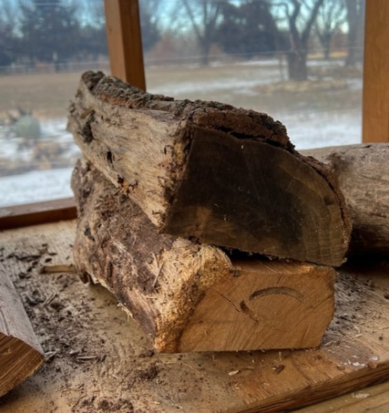

    I'm pretty new to this wood burning stuff, and still trying to figure out the best way to load the stove to get through the night. It's a pretty basic stove, a Pleasant Hearth 1800.
    I want to load it up for at least 4 hours, with enough coals to reload when I get up in the night. My fear is loading it up and have it run up too high on the temps while we're sleeping. I don't mind if my temps run up for brief periods on rare occasions, but I don't like the idea of it happening while we're asleep.
    My current routine is to load up with 2 larger splits, on a good bed of coals, with as little space between them as I can. The picture below is just an example of loading splits, with minimum space. I think with the minimum space, it will burn slower and not turn into a runaway fire. For me it's a safety thing.
    I'm wondering how others load up their stove for a bedtime burn, and what I could be doing better?

    Every EPA stove I've had I just fill as much as possible. We call that stove tetris. Leave smaller gaps, like you are doing and turn it down. It won't burn too hot, the wood just starts off gassing and that air is what burns.
    Try it when you are home for the day and see what happens before attempting an overnight if that helps.

    As such, I rake all existing coal to the front. I place 2 splits stacked, in the back of the box. Then, two splits on the coals in the front. I make sure they catch fire before closing the damper, forcing smoke and volatile through the cat. I adjust the air damper down to about half. I go to bed.
    I burn red oak overnight. Most every time, there's coals 7-8hrs later for an easy reload and reliant.

    I have a epa tube stove. No cat here. I simply pull the coals forward, then load it up. Tetris style when possible. Close the door, leave the air open to get it started, and then close the air valve. Gtg. Wake up in the am, do the same thing.

    When it’s below zero, I fill my Drolet 1800 to the burn tubes. Give ‘em a good char then close it down. I sleep darn well that thing is a tank. Good enough coal bed at 6 or even 7am for a fast start.

    I'm definitely seeing a theme here, I need to fill it tetris style, which I'm sure is packed in with minimal space between splits, get it going, low air flow, and let it go. I need to do some dry runs in the day, to get my confidence up, and trust it from there.

    The tighter you pack it the slower/longer it will burn!

    Load er up with some gaps for air and let er rip. Once it's going strong, turn it down in increments. Try something like 100% air, then 50%, then 25% with each adjustment being after the fire has built up strength. You'll develop a feel for how low you can turn it down and still burn clean.

    I mostly agree with what has been posted but would like to take it a step further and will use your picture as reference.
    When stocking the stove for a long burn I do pay particular attention to the choices for what I will use and what and how they will fit best. In your case my first choice would be that top piece and for nor other reason than it would make a goos starter piece.
    The first thing I do is shove most of the coals toward the front of the firebox. Then that piece would go in first at the very rear of the firebox. The longest side of that piece would be tight against the back with the smaller flat side against the bottom. For other choices I usually want a good solid piece preferably square or rectangle but at least like that one you have. Then fill the stove as best as you can and pack it as tight as possible.
    One other thing you can do, especially if the coals are not deep is to put one piece of fast and easy lighting wood on the bottom front. This will help the new load get started a bit quicker. In my case I like to use soft maple just because it lights off so quick and easy plus it burns hot and therefore the big load gets a good start.
    Most of how you set the draft depends upon your stove and the install. In my case, the draft is full open to get the fire going then cut the draft to around 25-30%. Usually within 10 minutes I close the draft further. Our draft control is marked from 0 to 4. For the long burn it gets set around 1/3 to 3/4 between 0 and 1. Then we can go to bed and sleep without worry.
    Remember they put draft settings on stoves for your control; use them.
    For sure, take a weekend or three to try setting the stove as you might for an overnight burn and see what happens. Also never forget that different types of wood will give you different results. One type might require a slightly different draft setting than another but it will usually be very small changes.
    As an example, last night was windy and chilly (16). I stocked the stove with all oak except one very dry ash. This was at 7:00 last evening. I got up at 5:00 (it is 6:39 now) and there were 2 large pieces still in the stove. I did roll them away from the back and added a small split as the house had cooled to 75 degrees. It is comfortable in my house.

    Backwoods Savage, Thank you for that write up, it definitely gives me more detail. Between this and the previous comments, it makes sense and I have a plan of action. I've burned enough wood, that I can understand how this works. I need to get some good pieces of wood that I can tetris together, and give it a go, possibly tomorrow. I plan on taking pics, and documenting it.
    As far as my stove goes, it's pretty basic. It has great draft once it gets warmed up, it's about 18' of straight pipe. The stove doesn't have any draft settings, but I've learned to adjust my air wash's air flow. It basically slides right and left, which I can also push it tighter to the stove, or away from the stove for a little more control. You learn to work with what you've got.. :)
