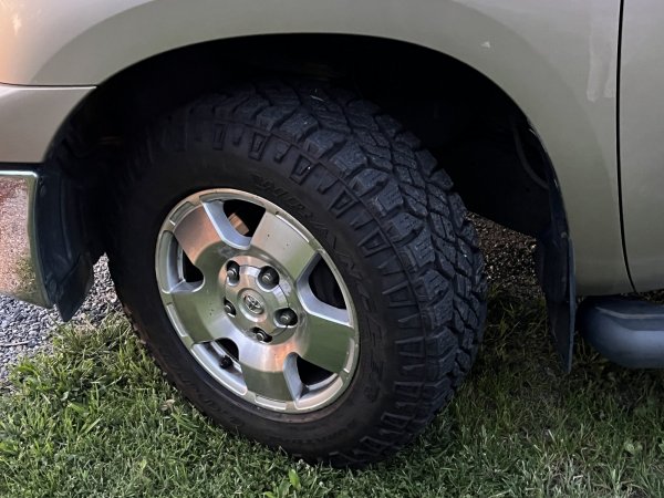

    Falken Wildpeak AT3W or the M/T if you want aggressive.

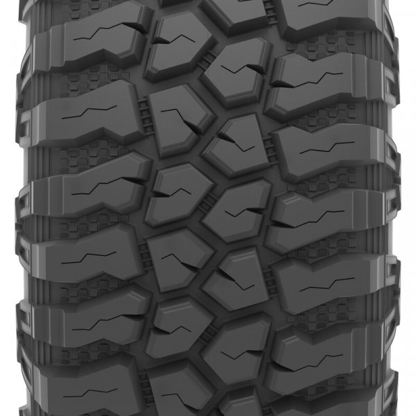

    I did just see these. Good Year just released a Wrangler Boulder MT. Now that’s sorta what I’m looking for.
    I worked at a tire distributor when I was just out of school loading, unloading, weaving un weaving 1000’s of tires a day. Doesn’t mean I know anything about todays tires but it means I think I do. LOL. Dangerous combination :) Anyway I guess I’ve always been opinionated about tread design. I’m not a fan of all the angled cross block patterns on the market these days. For high speed stability I like some parallel grooves to keep things running straight.
    If nothing else they’ll aerate the lawn :)

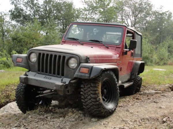

    Those boulders, to me, look like they'll be kinda loud on the freeway. But, probably great offroad and snow performance. We ran Mickey Thompson MTZ's on the Jeep for many years. Unstoppable offroad but howled like a wolf on the road. We bought it with Cooper Discoverer STT's. Those were pretty awesome offroad too.

    Yeah I’m sure they will. Probably not even that good in snow at speed. But I’m deaf and I can slow down a bit now.

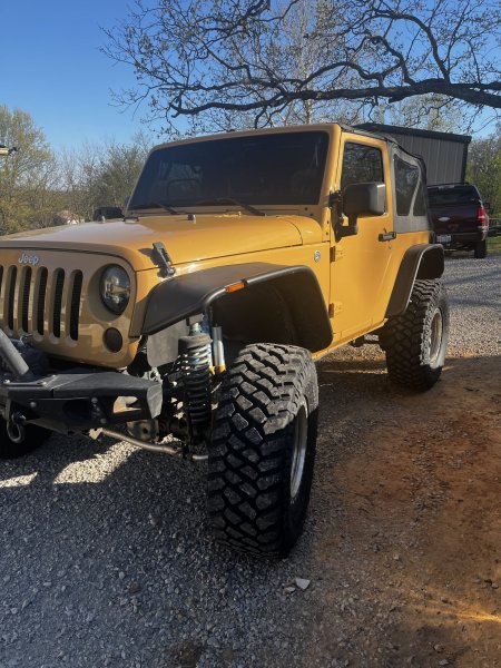

    14A16A94-D6D2-4C10-8F19-F02B6D8F4FFC.jpeg I don’t know the load range on them but put these on my jeep earlier this year. No snow or ice yet but they are nice on the road and chew up and spit out the mud. About 3000 on them and I am impressed. Firestone Destination MT.

    I'm running the Wildpeaks right now. Sure do like them! Great in snow. BUT, I've gotten them pretty caked in mud... a little too easy.
    I've run the Duratracs in the past and really liked them, too.
    I think I'll switch to the Duratracs for my next set assuming they'll be just as good in the snow, better in the mud, look a little more aggressive, but be louder on the highway.

    Not bad. I’ve seen those elsewhere. Not quite the size I need. Closest is 1” smaller tire. That would be good for an old short man who bought a high truck :) There are literally days I really do have to pull myself up by the bootstraps LOL
    Very similar pattern to what I posted above and the price is much more reasonable. It’s not a daily driver. More around the town truck. Thanks.

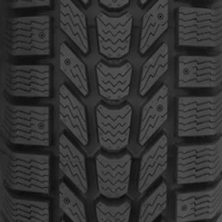

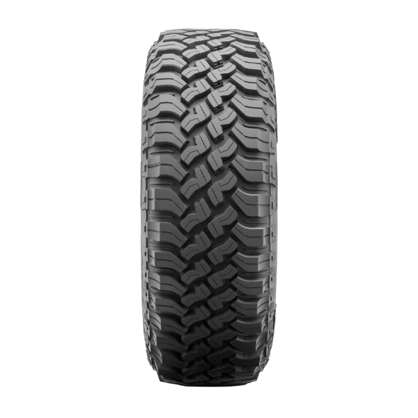

    I’ll share my opinion on tire tread design. Just an opinion, I have no education in the matter beyond what I think I’ve taught myself over the years being a hooligan in the snow.
    Most traction tires these days have a lot of 45* angles which is fine for traction at slow speeds. At higher speeds in the snow I believe much of the stability is gained by having parallel grooves and blocking. Your basically skiing at highway speeds in the snow. Hydrosnowing? The parallel groves keep you skiing straight whereas the 45 angles don’t know which direction they want to go.
    Two tires for comparison
    The 45’s I speak of. No parallel lines or angles to keep you running straight.
    Snow tire with parallel grooves and blocking. Good for snow, not so good in the mud :)
    I’m looking for the best of both worlds maybe. Once again just my opinion but I think modern tread designers has left some things on the table.

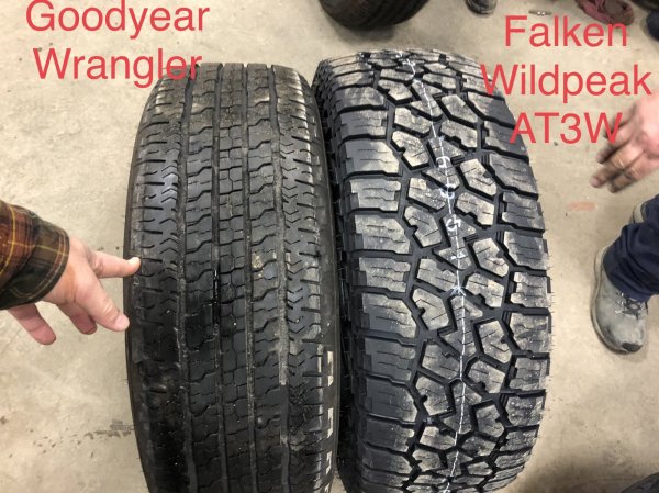

    That’s why I suggested the Falken Wildpeak AT3W.
    it’s got the siping (the actual name for this parallel grooves) you want and a more aggressive that the AT/ trail. (Similar tread pattern, but more a highway tire).
    the Wildpeak M/T is a lug off road tire but doesn’t have the siping you want.
    the AT3W was suggested to me by our local farm coop as they put that on their propane service trucks that service grain driers and livestock barns and have to get to the propane equipment on farms in less than friendly places with deep mud and snow year round.
    compared to the highway tires that have come on my pickups that got stuck on just wet grass, these things are incredible.

    technically the siping is perpendicular to the tire. The grooves like on the Wrangler run parallel. Those are the grooves that give stability at highway speeds in snow and rain also.
    Siping is also essential for good snow traction. It’s one of the things that makes a Winterforce tire work so well in snow only. In a smaller, lighter tire. To achieve the weight range they had to do a lot of cheating on the sipes and blocks. Basically with a WF in E range it’s not much better than a highway tire and once 25% of the tread is worn off it gets worse from there.
    The snow tires specifically made in E range work ok in the snow. On wet grass they’re not much better than drag slicks either.
