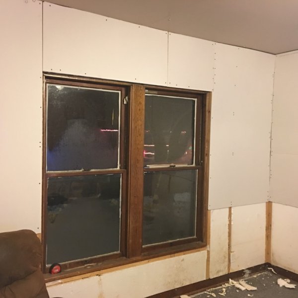

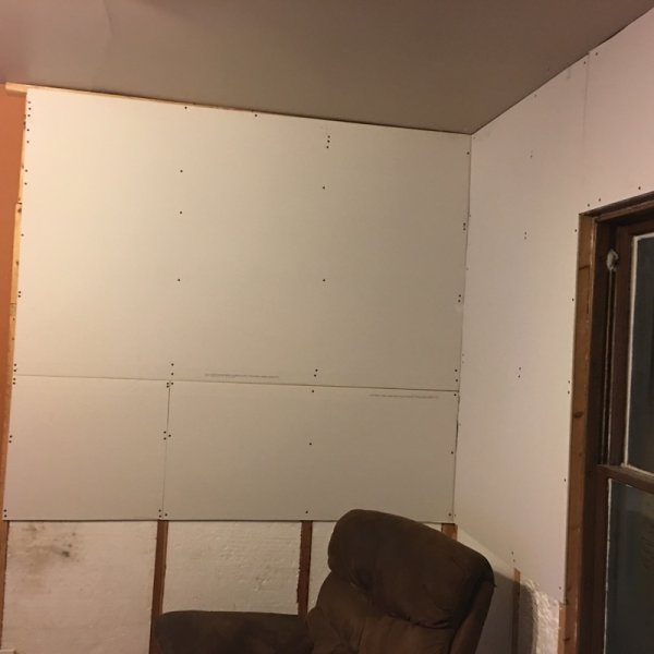

    Well folks, we are finally moving ahead again on our remodeling (shoulder injury has held up back for 18 months now). We are working on the living room and the goal is to get the drywall up, textures, and painted in time to put the christmas tree up on the 19th. We got one wall done last night and plan to do 1 1/2 more tonight and another wall on Thursday. Mudding starts tonight as well.
    What about that other 1/2 wall? Well I need to remove the door way and widen the opening, probably add an arch way to it. But thats not on our plate right now because I will need to get lumber for and things are tight for a couple more months yet. Besides, one thing at a time.
    We are only drywalling the top 6 foot, below that we will be installing a chair rail made of pallet wood. But that's not part of the before christmas goal, that will probably be a spring project so I can clear coat the pallet boards outside to have a better idea what each board will look like before it goes on the wall so I can make it more visually appealing. So I will probably do the door frame and finish the drywall on that half wall the end of January and then the pallet half wall in April or May.
    Aint remodeling fun?
    Below is a pic of what we got done last night. Dont worry about the small piece missing by the window, waiting for a drop of that is close to the right size.

    Awesome!! And I totally agree on wider doorways. My previous house had oversized doorways, moved here to like 28" ones:picard:
    Curious, why are you putting drywall up?

    Two reasons: the exterior walls are stucco and therefore were cold any uninsulated. We put up 2x2 and insulted with 2" foam inbetween on all the exterior walls.
    Reason 2: We can't hang things on wall very well. The stucco wont take anything other than monster cement screws. The plaster crumbles and the lathe behind it springs back at you.
    Also, I guess I have a third reason. It's going to look nicer and squarer when it's done.

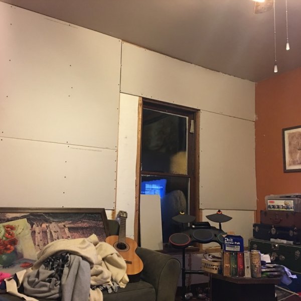

    More progress tonight.

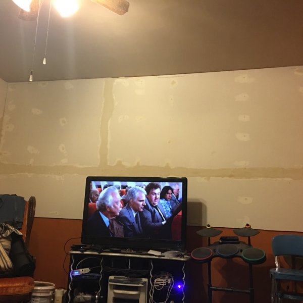

    Got the last of the drywall up, first coat of mud up.

    Looks good Griz and the movie that's is on the TV is awesome!!!
