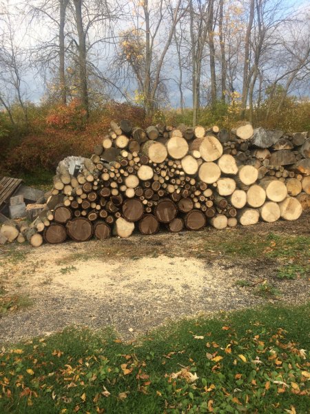

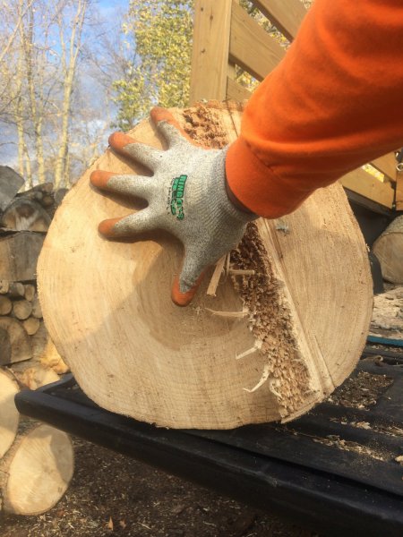

    Two years No leaves EAB tree from two weekends ago... solid as could be just brittle with a few small hangers and a s**t storm of dead toothpicks to rake up when it hits the ground
