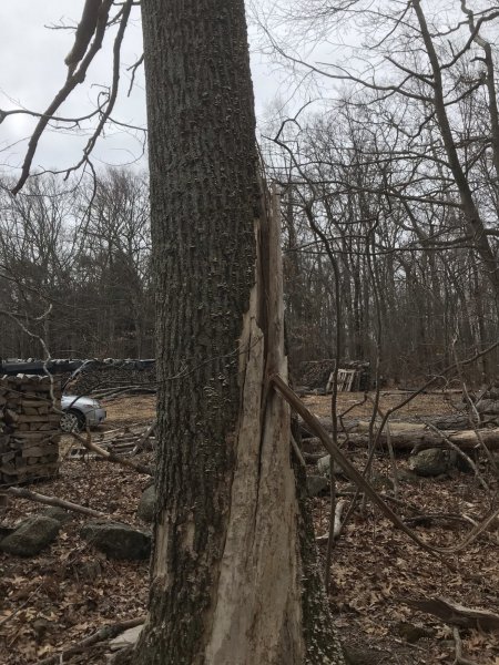

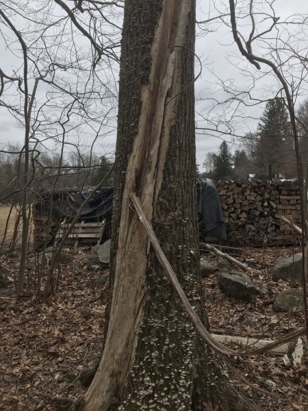

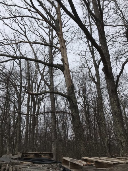

    My first project when I get saw time again. Lightening hit a dead tree,,,,twice I think. Leaning over what I plan on being the new processing area. So it needs to come down before any major processing begins.
    Not a fan of the lightening splits. Thinking plunge cut but the trigger will be tricky. I’ll wrap the trunk with ratchet straps. Have some heavy long ones which should wrap around 4-5 times increasing strength. Direction fall will be as in the second pic.
    What says the crowd? Any sage advice? PS. I won’t be alone for this one. Someone will have a cell phone handy :)

    No advise, but it sure looks twisty! It'll make some interesting splits.

    Move all your valuables away. Without seeing it in person it’s hard to tell what may or may not happen when you start cutting a spiral fractured decaying tree. If you are not comfortable or confident in your approach call in a bucket or rent a lift and disassemble from top down.

    Only valuable is the stack of hickory. That’s the natural direction of fall. I wanna send it off to the side instead of moving wood. The car is just my runabout. I’ll let it drop on those pine logs. Keep it off the rocks a bit maybe.
    As I write this I’m thinking extra thick hinge,,,,massive really. 6” of hinge and plunge out the back. If tree doesn’t fall at least I’ve released the pressure on most of the split wood and can run in to remove some hinge. Just spitballin

    from the pics it looks like the lean is in your favor and no major items above on the back cut side. I think I would chain/ratchet the split in a couple of places, especially low where the notch/back cut will be and cut per normal procedure.

    Can't tell if it's red oak or ash. I would remove splintered wood and probe to see if it's soft/ rotten in center.
    Lightening does weird stuff inside trees. Looks heavy to left side.

    Short of that though, as was mentioned before, getting up high and doing some cutting to reduce some of the mass of the tree first can't hurt. At least if you're only dropping a limb-less trunk, the chances of it disintegrating on the way down are lessened.

    Red oak. Never can tell for sure but little chance and zero sign of rot. It was a nice healthy tree until the gypsy moths killed it a few years ago. The cracks are fairly deep and radial into the tree and on the holding side.
