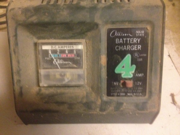

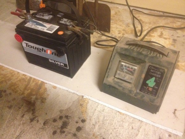

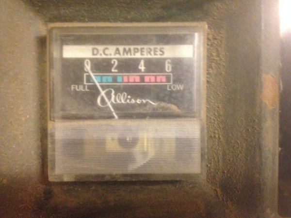

    Hey folks. Can you tell me anything about charging this battery?
    This old charger was given to us many years ago in a box and I have never used it. I now have have a tractor battery that needs to be charged.
    I plugged the charger in and you could hear it running immediately. But I do not follow the read out. I know the battery is almost dead because it would no longer turn the tractor over at all.
    I have taken pics of the charger when it is plugged in and hooked up to the battery.
    How do I read it? How do I know when the charger has brought the battery to capacity? I don't want to leave it plugged in overnight. Right? I believe you could overcharge the battery?
    Why when I hooked it up is the needle showing to the far left, green, and says full?:confused:

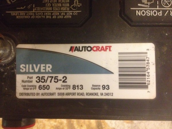

    Advanced Auto web page specs say it is a 12v battery. Phewww. I do have it on the 12v side with the switch. The charger will do both 6v and 12v. So how do I read this bugger correctly and how do I know when the battery has been charged to it's full capacity?

    there may be an open circuit in the battery and is causing the charger to read full or the charger is defective.
    Hook the battery up check voltage (assuming it's 12V) should read 12+ when you crank the starter if it drops severely to less than 8V the battery is pooched
    Pot the caps on the battery and check for fluid level - add distilled water if low and recharge if necessary

    could be just a bad gauge on the charger as well, they are a simple induction coil would need to check the resistance on the coil for continuity

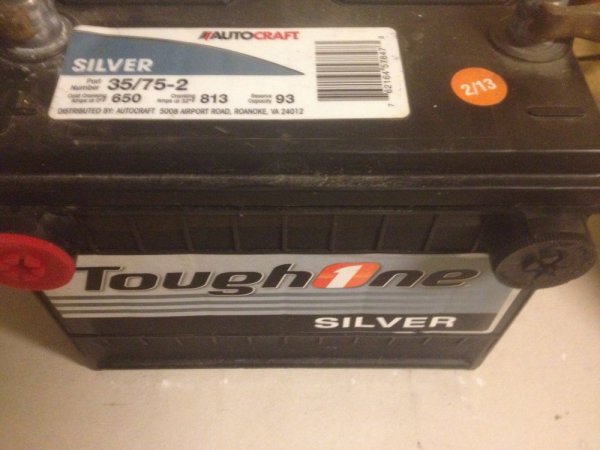

    Basod. You are talking to Gasifier. Completely inept at all electrical "stuff". I do not know how to check the resistance and have know way of doing so. Any way I could know if the battery is charging or not? The battery has a sticker on it that reads 2/13. I think it is a fairly new battery. Of course, if it was never charging when we were running the tractor, it has been killed on several occasions. :rolleyes:

    Gonna have to try REAL hard to hurt that battery with a 4A charger. If the battery has been deeply discharged and exposed to cold weather, it may have frozen, which would result in a "pooched" battery. :rofl: :lol:
    Any auto parts store should be able to test the battery for you and tell you if it's good bad or ugly.

    Needle on charger should move if you have a good connection
    3/13 date, don't think it froze ( yet )
    Suspect charger

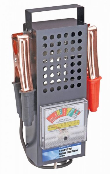

    As mentioned an auto parts store will have a load tester to check the battery. On bad batteries if you put a meter on them it may look like it has a full charge. However when you put a load on them (50 amps or more), the needle will drop down to the red area of the gauge in less than 5 seconds. Right now Harbor Freight has a hundred amp load tester on sale for $20. Handy for testing alternators also. Load Tester.jpg

    If a charger goes to full almost immediately it is usually a bad a battery or needs to be topped off with acid. The other thing it could be is an incorrect gauge on the charger.

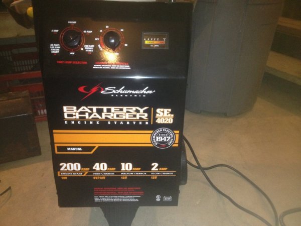

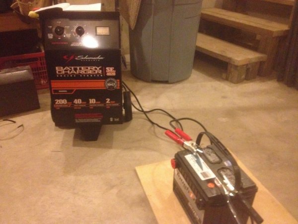

    Battery test showed battery good. Charging needed. So now we know my old charger belongs in the electrical recycle bin!
    This little baby is on the job. :D
    On sale! Conveniently!
    Pallet Pete likes this.
  19. Gasifier
    20,433
    103,362
    $109
