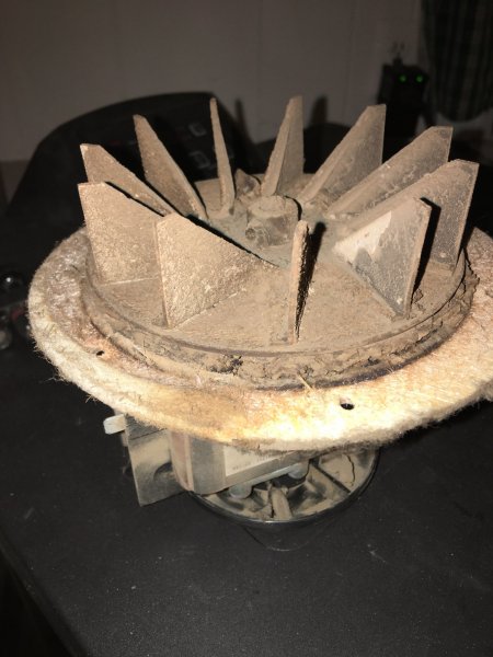

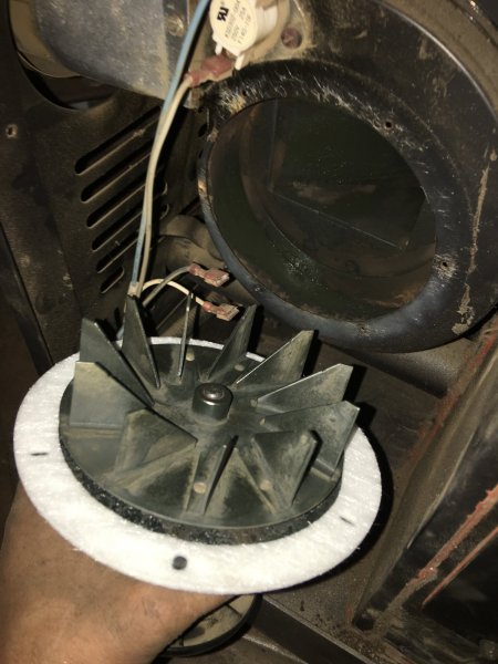

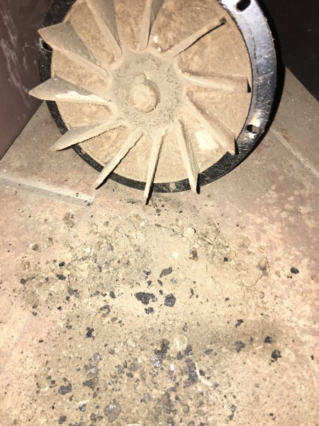

    Every time I take the exhaust motor out there it is! LOL
    If a double paddle blade came in 4.75" in diameter that would keep the ash down to a minimum!!! :)
    Would a ceramic coating on the petals help?
    Is there a way to make it self cleaning?
    It would be nice to press a button and then some nylon bristles would flip down for a few revolutions and wipe it clean!
    Maybe different shape petals to direct some of the air down to wash the mounting hub like an air wash???
    See dirty pics below
    A little Dry Moly does help.
