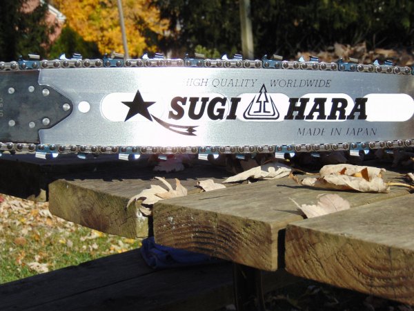

    I know that in a large Husqvarna mount pattern a 28” sugihara weights the same as a regular factory 24” husky bar. Don’t know if that’s helpful to you or not. I’ve got almost all my saws wearing reduced weight bars. Partly because they look so cool, and also for the weight savings. Sugihara are pricey but I think they are going to outlast a standard bar, they are HARD

    Honestly, I thought about "trashing" a bar to see how light I could make it. I've "skeletonized" things before...
    The problem is our bars are not just a slab of steel anymore. They're more like plywood and unless you fill in those voids, it would probably come apart. In a very bad way...

    From taking a quick look at that bar, it appears to weigh less than 4 lbs; how much weight do you really expect to save by drilling? Hell I can save you more weight, 1/2 tank of gass and 1/2 tank of bar oil.... Just say'n.

    That's a really good point. You can see how much material they remove from the light bars. Even replacing it with aluminium, it's a lot.
    On mine, the 28" was uncomfortable to use. feel Heavy AND unbalanced. I also that it's a bit much full comp chain for a stock 391 to pull.
    The STD 25" wasn't "bad". But the light is OMG! nice to move and cut with.
