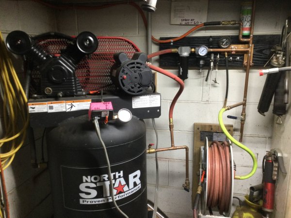

    I put this one in a few years ago . It’s been dead reliable and relatively quiet .
    Pro tip : leave it on the shipping pallet ,or get those mount pad thingies .
    Northern Tool has sales on them fairly often . 34054CFF-15CA-47FF-85DC-4B40D49937C9.jpeg
