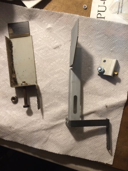

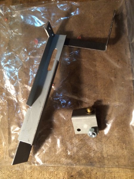

    Pic 1 - New rod and Bullit
    Pic 2 - Original Damper rod in stove
    Pic 3 - Old Damper left vs New Damper right

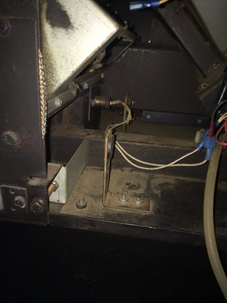

    Pic 4 - New Damper installed in stove
    Pic 5 - New damper rod now easily accessible

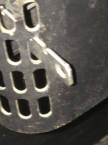

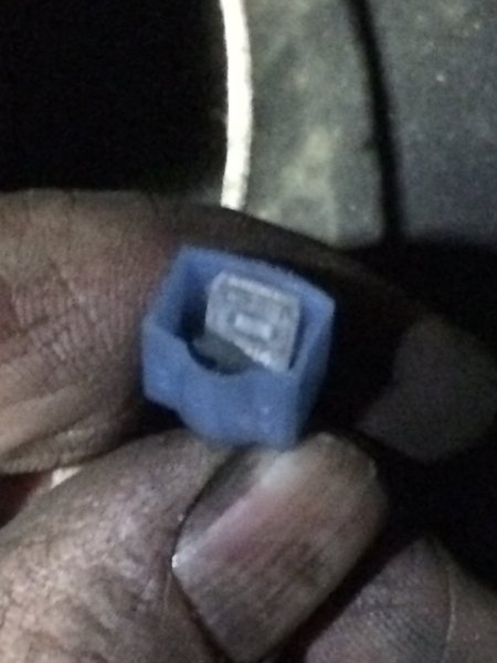

    The igniter did not work because the male tab in the connector was bent back! I wonder how long it was like that? LOL
    See pic
