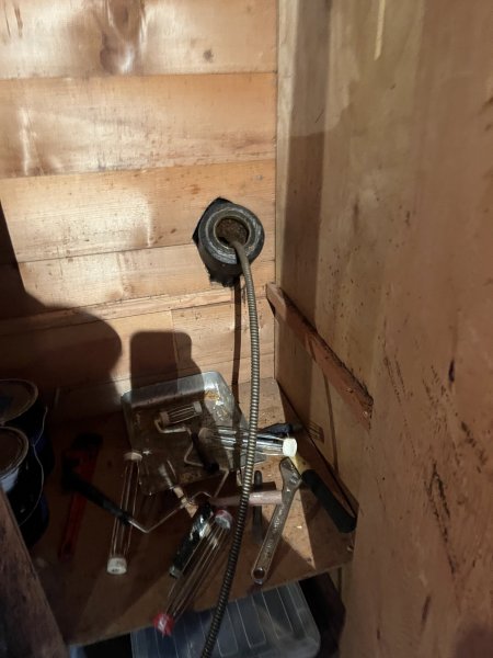

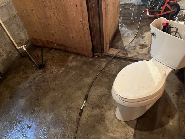

    DAAAAAD, what do we do. The lower drains and toilet have stuff coming out of them. Sent a couple(not safe for hoarders) pictures, hmmm. Either the septic tank is having trouble or there’s a plug in the drain line.
    They lucked out. It was a fairly easy plug to bust loose. Ended up renting a power snake and got things moving. He asked, what happens if this doesn’t work? The look was priceless when I said, if this doesn’t work then you start digging.
    Now they believe and know why certain things don’t go down the drain like when they lived in town.

    Aww, no fun, then the clean up. Looks like they lost a rug too.
