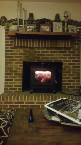

    Well I have had a few fires in the nc30 and things seem to be going well. Still learning and trying to refine with each burn. Got the STT to 730 or so and it made me a little nervous. I didnt even load the stove full and reduced the air pretty early on in the reload.
    So I'm sitting here keeping an eye on her before I go to bed and sweating lol.

    That's pretty hot for this time of year.:fire:
    I usually start reducing the air by at least 1/2 when the STT gets around 400 or so.
    Lots of variables re: how much wood, outside temp, type of wood, how soon you reduce air and by how much.......etc., etc.
    I can run the stove at about 500 very easily without it getting out of hand. Don't be afraid to shut the air all the way once the stove gets hot. If you lose flame, open it back up and the flame will come back. Give it time. VERY small adjustments make big changes, once you get down to less than 1/2 air.
    Now's the time to play a little, before it gets too cold.

    Beautiful setup, my friend! Once you get the stove dialed in, you'll find it quite enjoyable to operate I'm sure.

    Wow, that looks like a January fire. Open the windows. Great that you got it installed and running properly.

    That's a great picture right there....love it

    This stove loves to run between 700-750 when it's cranking. Just keep it south of 800 and you don't have anything to worry about. It's a great heater, and would be at double what they charge for it.

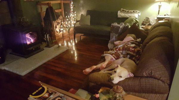

    Your dog is living LARGE right there! ;)

    My 13NC is the same way.
