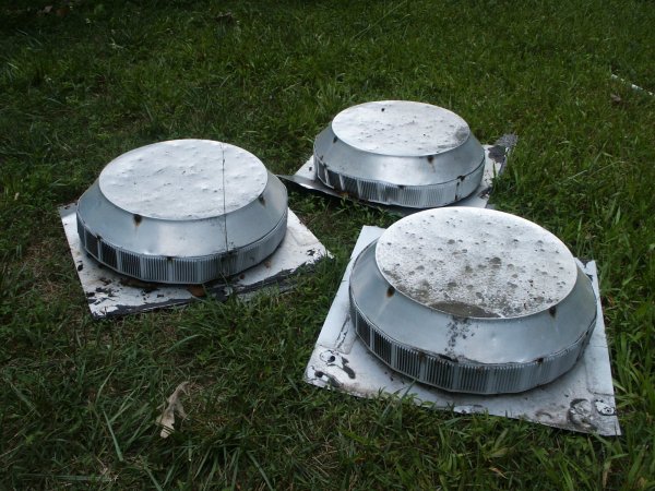

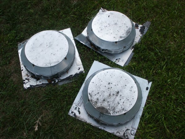

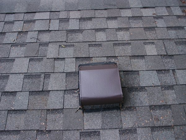

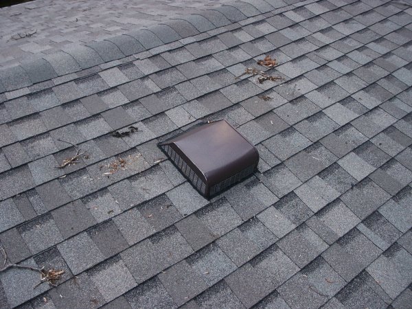

    I had the roof leak in my bathroom; I knew the roof vent was installed incorrectly, you don't cover the lower area with shingles. They had caulked with silicon and it had shrunk; so I pulled it off and replaced it with roofing caulk. I thought the leak was stopped. Last night we had some very bad storms and when I went to bed I noticed two bad leaks in the bathroom; close to where those vents are located. I also found a small leak in my little office which is at the other end of the house from my bathroom. There are areas of the roof where I think joints are not staggered and I know they did not install any starter strips.
    I have the old vents. Today I went on the net and found some roof vents for a 14 inch diameter hole which is what the old ones are sized, at Home Depot, order online only, for $36.xx. Need three of them.
    The purpose of this post is to ask for opinions and maybe someone with a cheaper source of vents or if I can use the old vents. Photos follow. I need to stop this leak before my ceilings are damaged. I also have some bundles of shingles left over, six or eight or more.

    OK kimberly, the vents you are discussing are humidity vents. meaning this the white 3 inch pic pipe should not be caulk ed like that it should have a rubber boot. that is an air vent for your plumbing.. the brown vents that are that size should be attached to a bathroom fan to reduce humidity when taking a shower etc.. or a stove while cooking.. how many bathroom or exhaust fans do you have? how bad is the leak? if it's a small leak it could be the condensation because the idiots.. trying very hard to watch my language here, did not connect the hose to the vent.. think like a dryer hose that goes outside they disconnected the hose and did not reattach.
    Sorry to tell you this I do not think shingles were installed correctly. in bottom picture to left of green leaf rows up there is a seam that looks to be 2 shingles high. theses appear to be arc or architectural shingles charcoal. was the first layer removed? if so what is underlayment did they use ice and water? a roof guard or just tar paper.
    so step 1 how bad the leak? this is no real roofer I've done 30 roofs that's 29 too many and it is not that hard there are instructions on the back... I am not a professional but I would not have let that go..

    before I replaced the vents are the gaskets etc bad or where they just installed wrong? if vents are OK why put in new ones? put old ones in correctly.

    OK next question on the side that is flat do you have a gable vent and or do you have access to attic?
    I am sure you know this but the purpose of venting a roof is simple the conditioned air in the bottom (whether it be hot or cold) condensate when it meats unconditioned air above so the venting is air movement so it does not mold. there are several ways to accomplish. soffit to ridge vent is common think air slots under eaves to a fiber mesh at peak works best imo. also gable vents think octagon shaped shutters at end of house or the vents you have probably least effective. if budget is real tight and you know we're leak is coming from flex seal as seen on TV will buy you time.
    Kimberly I think you got my luck, if I pick up a stick and not dirty end put it back so I'm not stealing!
    a reason I don't like your type of vent is they leak all protrusions thru a roof will leak about year 15 to 20 I am guessing that is age of your house?
