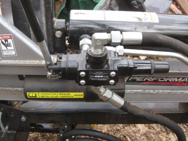

    Hydro developed a slow leak. Gradually got worse and thanks to some help from buzz-saw i determined it was from failed tape on a connection. Some tinkering yesterday and i got it fixed...for a short time. Started leaking again and ill redo the tape today.
    IMO this is a poor design. The part with the lever attached "floats" and when lever is pulled it can tilt 5- 10* forward or back and no way to tighten it. Anyone have any hacks/modifications or experienced a similar problem?
    Ill get better pics today. First pic is where it leaks. IMG_0807.JPG IMG_0808.JPG

    Is it leaking from the fitting that your finger is by on that first picture? I would try some pipe dope on that fitting. You can use dope and tape together as well. We use a product called expando but it gets hard when it dries and makes it really hard to undo so I would only go that route as a last resort.

    That valve really needs to be supported probably from some sort of a mount to the cylinder.
    It is relying on just the short nipple that goes from the retract side of the cylinder to the valve.
    Certainly not the best design.

    The more i used it and the first time it tilted i thought the same. Too much stress.

    yes, plumbers tape...teflon. I did it cold and it doesnt get too hot. It had tape on it before i fixed it so factory applied

    Just wasn't tightened up enough, that's all. Simple fix, just remove the rigid pipe connecting the cylinder to the control valve and remove the elbow that's leaking, dope it up and re-install it making sure it's tight enough. Then just re-install the pipe. I believe the piped ends have o-rings.
    Most all cheap consumer grade splitters have the control valve being supported by the fittings, nothing new there. My Speeco was the same way as is my TSC Countyline (made by the same company who made yours). I have the exact same setup as you have.
    Just need to tighten/dope up the fittings. All mine were tight, as I went through the whole machine before hand to make sure I had no surprises when I started splitting. I have ~18 cord through it now and I haven't had any surprises......yet.

    Dismantled and retaped this afternoon. Fired it up and no leaks. Ran it for a good hour too.
