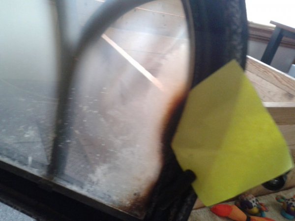

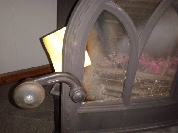

    I thought the door was leaking, but check out the window. The post it paper went right through. Not a good time for this to happen.

    Yikes thats not good at all and Im afraid I have no way to help you but hopefully you get it fixed quickly and easily.

    Its probably been like this for 2 weeks. Too bad my stove shop closes in a half hour, otherwise I would get the gasket kit and do it tomorrow. Minus 20 WC tomorrow night.... this sucks!:mad:

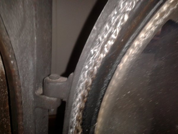

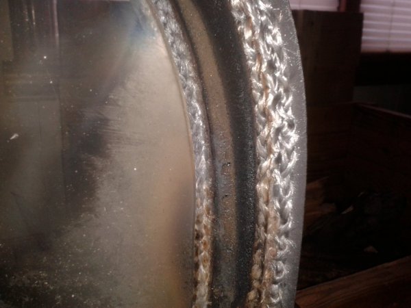

    Here is 2 pictures... the first one is with the door open the right side and the second picture is with the door open left side.
    It looks like the window slid to the left and if I loosen the clips and slide the window right back to being centered would work ok??
    What do you guys think??

    Worth a try..

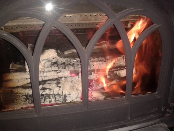

    ok, I slid the glass over. Actually I had to remove the entire window because the metal track that the window is housed in was off, maybe from the factory or screws loosening over time. Anyway, the window is back in, everything is lined up and I will start a small fire. I hope I tightened the clips correctly. I kinda pushed on the glass so it was tight against the gasket while tightening the clips. I ran the post it paper pictured earlier throughout the entire window. Everything is snug, except for a very small area where only a 1/4" corner of the post it slid in.

    Maybe only slightly, if at all. Before I slid over the window, the gap was small, but was close to 3"long. I will schedule the stove shop I bought the castine from to come out an re-gasket the window, door, and ashpan while they are here. The thing is, this is only my 3rd burning season, so I'm kinda surprised this happened. I'll keep ya posted here. I added a few more splits here, and its starting to get going. Stay tuned!!!!
