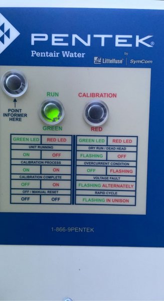

    This is a well monitor that i heard about recently. (It's more for protecting the well pump from high amp and run dry, rapid starts)
