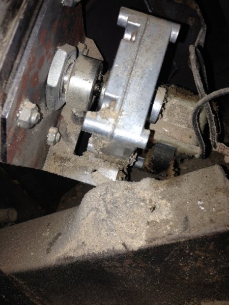

    The squirrel cage room blower was full of sawdust, so I pulled it out and saw a mound of sawdust! Maybe that is why there was sawdust all over the carpet?
    Looks like a bad Nylatron Auger Bearing? The auger does wobble around in the bearing plate hole.
    Has anyone seen this?.
    See pic
    Older Merkle-Koriff auger motor in a Whitfield Advantage Plus

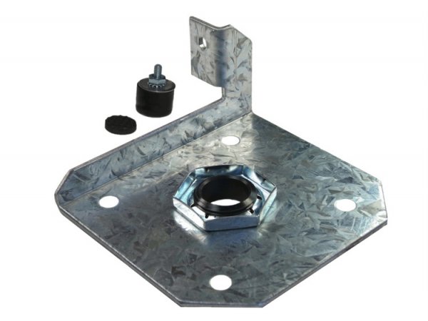

    Sounds like the lower auger plate bushing, or what else others may call it....

    No, I have not seen this happen on a Whitfield before and wanted to know if anyone else has seen this happen?

    I have a couple of bearings on order. It may be a good time to "Pimp the Auger" - check for burrs and "Auger Pox" and install a brand new high quality Gleason-Avery auger motor?

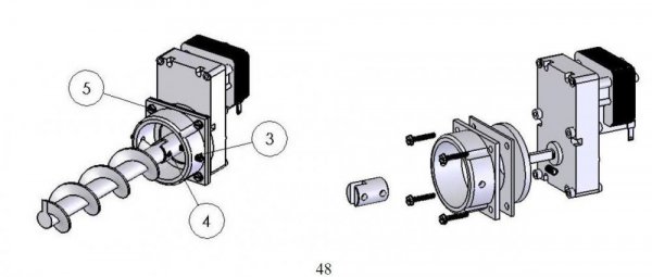

    on the auger? doesn't have one , its direct drive straight to the shaft, we have a cast sleeve which fits over the feed tube and a heavy rubber grommet between it and the motor itself to seal it up. no need for a bearing
    http://www.englanderstoves.com/manuals/25-EP-EPI_Combined.pdf
    check page 48 of this manual for the exploded view of the auger and motor assembly

    Oh, yes, thanks for refreshing my memory. I have worked on a few and sold 2 new ones. I only replaced 1 auger motor so far. They are pretty rugged machines! I like them. :)
    Therefore the 25-EP relys on the bearing in the auger motor. Smart Design. Why have two bearings? LOL

    yeah, unless you are going to float the auger in the tube a second bearing is overkill. we do it with bottom feed units but its not necessary for top feeders if the feed system is well thought out

    yea, looks like fines to me have migrated thru the bearing.....termite and carpenter ant leavings are different, from what ive seen

    Stop feeding it fines.
