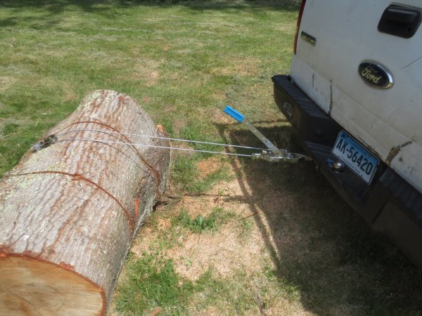

    A cant/peavey but those are limited to smaller diameter logs. A lever either a 2x4, 2x6 etc or one of those heavy steel pry bars. I used a clothesline hook attached to the log and the come-a-long hooked to my bumper to roll a log that wouldnt budge. Worked like a charm. IMG_5230.JPG Here's the link.
    Ive Come a Long Way in my Hoarding Career!

    That's what I was thinking, but using a chain instead of the come a long. I need to hook the chain so the log will roll as I pull forward.

    Dakota - I was unable to get a chain under the log so I was able to drive the hook from my peavy into the log and attach a chain which was connected to my truck. The first pull had the tires spinning, so had to use 4 wheel drive to roll that log. With a large patch of mud exposed, used an axe to clean off so I could complete my cuts. I"m not to sure what kind of maple this log is, but my wedges would not stick. Therefore those rounds were noodled into wedges.
