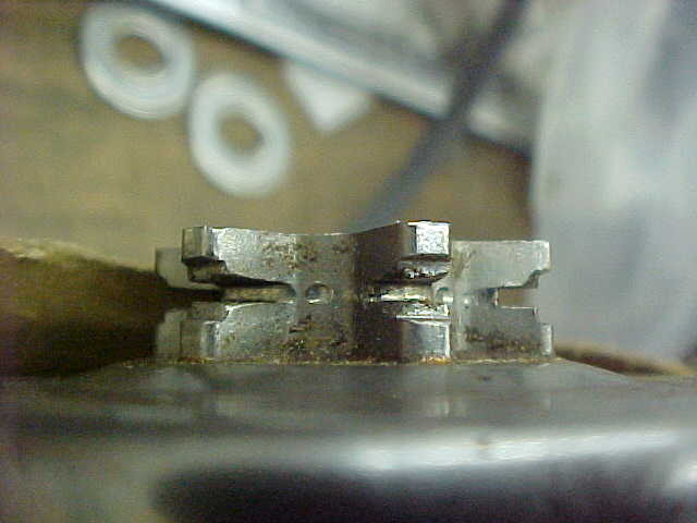

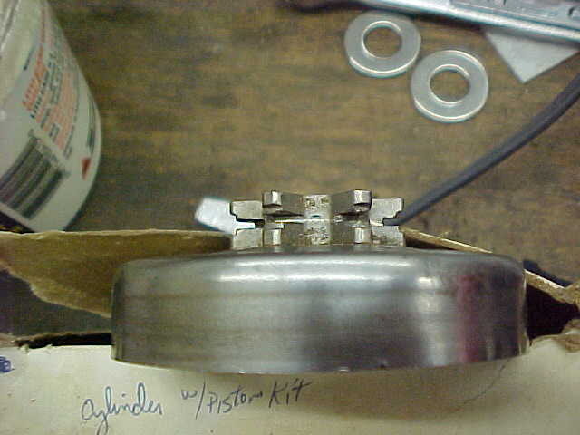

    You guys will get a kick out of this. Had a friend who knows I'm into saws ask if I'd look at a friend of his saw. Said it didn't have any power and the chain is sharp. I figured the rakers were out of whack so I told him to bring it by and I'd have a look see.
    Once I saw it, it didn't take long to figure this one out After a new bar, chain and sprocket he was amazed how well it cut.
    Gee, I wonder why?

    When the chain sinks into the bar this deep, it might be time to replace. Wear was about 1/3 up the rivets on the chain as it had sunk in so much. At least he wasn't using change oil from a car for lube. Put a lot of extra wear on that saw for no reason. I did check the oiler and was working fine but he said the bar was getting hot. Yeah, that doesn't surprise me. What does it take for people to put 2 and 2 together?

    Probably hasn't had any lube on that sprocket bearing in some time too!

    Good catch & repair :yes:
    I didn't know about the drive sprocket with my first saw.
    I ran it until the sprocket looked just like that one.
    New bar & sprocket (Changed to the rim type), & a learning experience,
    Husqy 61 lasted 30 years (still runs, good back up saw)
    We all experience learning & teaching moments, use them both well :)

    I've had those come in where the spur was cut clean through.

    At what pint should one replace a spur clutch? I have always had rim sprockets until I got this husky 455. I want to run the spur clutch until it is used up then switch to a rim sprocket clutch. Just starting to get marks in the spurs.

  17. Scotty Overkill
    9,614
    64,518
    Where I'm from there's guys that'd take that sprocket, build weld back up in those worn out teeth and file them back down to reuse it.....no lie...
    And no, it's not me.....lol

  19. MasterMech
    9,648
    26,024
    Greenville County SC
    The problem with Spurs is that tou have to replace the whole drum at $20-$30 a pop. Rim drives are dirt cheap at $5-$10.
