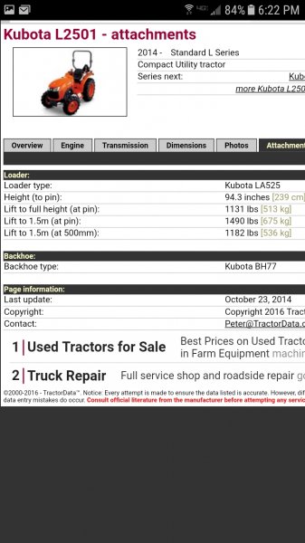

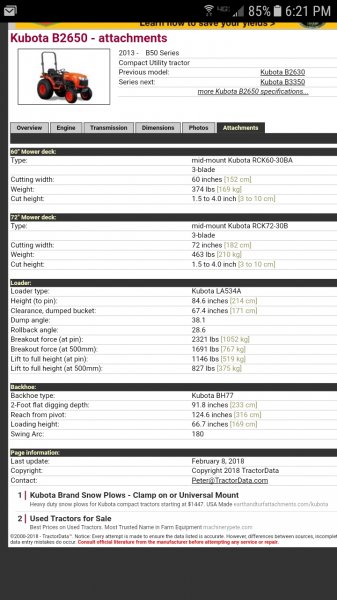

    I believe your loader with a lighter forks attachment should handle 1 pallet stack or what Jack Straw does should easily work. The specs between the 2501 & 2650 are nearly identical. Just today i easily lifted a whole log of poplar 20" wide x 10 ft long, so once split, that'll be pretty close to filling a pallet rack. Sounds like you got some great attachments!
    Maybe we can get a bunch of us to do a tractor pull at the g2g!
    :tractor:\_____________/:tractor:
    I know basod picked up the exact same tractor a week ago.

    That’s a great comparison! Thanks! It’s odd that they list breakout force on the B but not the L, and left a lot of the other stuff out too it seems now that I look a little closer. Thanks for the link also. I’m trying to look at all the different ideas I can. So far I like the pallet with cattle fencing around 3 sides. Looks convenient and pallets are free. The fence has a cost but it’s only once at least.
    That’s a pretty impressive lift on the log today. What do you have for forks? I was thinking the lightest 42” I can find might be best as long as it’s rated for at least 2500 lbs or so. Gotta have a little buffer.
