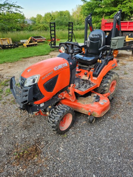

    Pulling the deck is a little bit of a PITA (BX2380) due to drive shaft and persnickity connection hangers for the deck. HST has a little 'coast' to it that takes some getting used to compared to other hydro stuff I've used. Brushguard has tendency to wiggle loose from it's holders (they pivot for hood clearance when opened).
    That'd be the 'negatives' that come to mind.

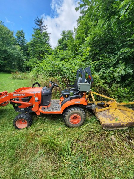

    You can hang a 4' bush hog without front weights. (weights would be better) It's kinda a long thing if you use the loader for ballast while hoggin. Deck will put down a decent looking cut if that matters to you. Seems to have plenty of power. Mounting/unmounting loader is done completely from the operator station...fairly slick. Have not seen much in the way of failures a couple years on. It should easily live to 1500 hours.
    One thing I've come to learn about small Kubota diesels....keep the fuel filters serviced and fuel as clean as possible. Kubota's don't like even a little bit of dirt in their systems.
