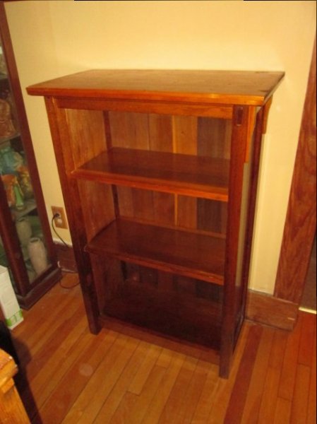

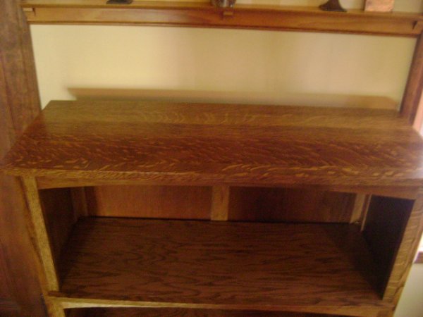

    I have the K 4 set up. For furniture and cabinet building, it is excellent. I rarely use my biscuit joiner or dowels to make connections. You can even join board edges together for a tabletop. I have made an oak bookcase, walnut bookcase, my daughters desk and now one for my son. The joints are tight and you can buy different species of plugs to match your wood. The plugs are not standard dowel sizes, as I have already tried to save a few bucks. The Kreg plugs are nice and snug. If you are making furniture or other projects that require joinery, go for it.
    Walnut and poplar book case
    quarter sawn oak bookcase

    good looking stuff, fishing! Yea, historically, I used biscuits for joining, as in a top, but perpendicular joints, stiles and rails, etc can be problematic........I have heard about them....sounds good.......do you glue and screw, or just screw them? ive heard both ways......

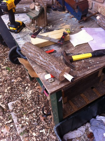

    I'm getting one. How I've made it this far in life without those jigs is beyond me.....
    I'm also going to buy a set of those bits for turning dowels on the ends of small logs for making rustic furniture. I've got some idears.......

    I saw an ad for those dowel-turnin machines in a magazine recently. I was surprised how inexpensive they are. Made me think about getting one too. I made these legs for a foot stool for my mom, made out of a 1/2 round of red oak. I roughed it out with the saw, and then chiseled and sanded till round. A machine would sure be quicker though :D

    I use my lathe to more or less the same effect, but those jigs for doweling the ends of logs are slick. You can use them in your cordless 1/2" drill!
